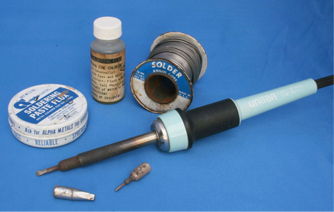

Soldering Iron
Modeler’s Vise or Frame (optional)
Solder
Damp Sponge
Flux to remove oxides

Step 6: Cleaning the Soldering Iron
Because soldering irons get so hot, they oxidize and become dirty quickly. They key to reliable connections is clean components so make sure that your soldering tip and parts you are joining are clean. To accomplish this, pass the tip of your soldering iron on a wet sponge until it shines.
Step 7: Apply Flux
In soldering it often becomes necessary to use materials called fluxes to help remove oxides and keep them absent while you solder. Flux needs to melt at a temperature lower than solder so that it can do its job prior to the soldering action. There are different methods to apply flux. The method you choose will be dependent on the items you are soldering.
Step 8: Tin the Soldering Iron
If you want to know everything there is to know about how to use a soldering iron, you’ll need to know how to tin. Tinning is the process of coating a soldering tip with a thin coat of solder. Melt a thin layer of solder on your iron’s tip. This aids in heat transfer between the tip and the component you are soldering, and also gives the solder a base from which to flow from. This process may need to be repeated as you solder. You will only touch the tip of the soldering iron to the solder when you tin. Do not touch the tip of the iron to the solder while you are actually soldering.
