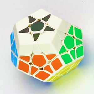

Step 1: [EO] Orient the Edges Forming the Gray Star
First we must for the Gray Star on Top by Orienting the Edges with one easy Algorithm
EO Edge Orientation – F R U R’ U’ F’

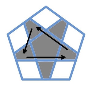

6:02 Step 1: EO - Case 1: Arrow
7:30 Step 1: EO - Case 1: Arrow Troubleshoot & Practice

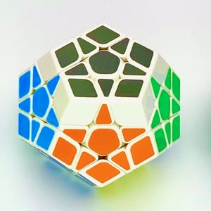

Step 2: [CO] Orient the Corners to Get All the Grays Facing Up
We not need to Orient of flip all the Corners so the Gray is facing up with one easy Algorithm.
CO Corner Orientation – R’ D’ R D

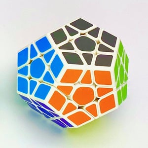

Step 3: [EP] Permute the Edges by Positioning Them in the Correct Location
Now we Permute or place the Edges in the correct position relative to the Center Colors with one easy Algorithm.
EP Edge Permutation – R2 U2 R2’ U R2 U2 R2’

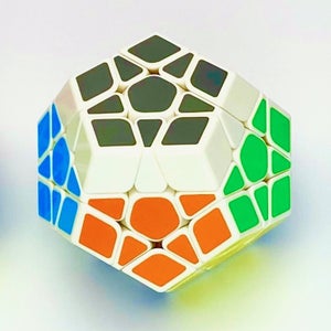

Step 4: [CP] Permute the Corners
LAST STEP
Next with Permute or fix all the Corners by placing the in the correct location relative to the Edge pieces with no Algorithms. Just learning how to position them with logic.
CP Corner Permutation - No Algorithm needed
