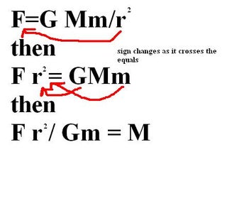

Maths is crucial for solving the problems that will follow, you will need to understand standard index form numbers where you have Zx10^y this will give you a long number starting with z followed by y zeroes( 2.99x10^8=299000000), also you will need to be able to rearrange equations such as E=mc^2 into m=E/c^2 and more complex examples such as newton's law of universal gravitation. To do that for example if we wanted to find the mass of an object from already knowing what it's force upon us was, what our mass is and how far away it is we would do something like this. M is the objects mass, m is our own mass, G is a constant 6.67x10^-11 and r is how far we are from the object
F=G Mm/r^2
then
F r^2 = GMm
then
F r^2 / Gm = M
this new equation lets us put in the numbers and get the answer out. Do not fear letters in maths!

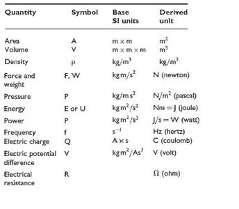

Step 5: Units
So far i have explained about equations and formulas but i have not mentioned how we measure them, yes it's alright that E=mc^2 but that means that if we do not use standard units for the energy, mass and speed of light two people can get completely different answers. Alice measures a mass to be 45000kg and c to be 3x10^8 ms^-1, she gets a mass energy of 4.05 x10^21. Bob also performs the calculation he uses a mass of 45 metric tonnes and a speed of 671 million miles per hour, he gets an energy of 2.02x10^19. they can't both be correct. To avoid this we use particular units for certain quantities like kilograms for mass, ms^-1for speed and velocity, Newtons for force, kgms^-1 for momentum, volts for voltage, amperes for current, ohms for resistance. If a quantity you are using is given in kilo or mega units multiply by 1000 or 10^6 respectively. For milli units divide by 1000, when using kilograms this does not apply as the kilo unit is standard not the gram however most masses are given in kg, grams or metric tonnes. This way Alice and Bob must use the same numbers for the same object and get the same answer which is given in joules.

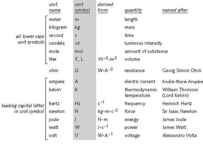

Step 6: More on Units
Quite often you can have quantities,especially constants given in very strange units, this is because the units must cancel out to make the units on the other side of the equation. Also we can sometimes almost find the equation just from knowing what the units are for example knowing that newtons can be written as kg m s^-2 we that momentum which is in kg m s^-1can be divided by seconds to get force. This turns out to be true as F=(change in momentum)/ (time for change to happen). Also amps(C s^-1) multiplied by volts(J C^-1) cancels to remove the C from the units and give joules per second ( power). We can use this to deduce that planck's constant found in the equation E=hf must be in J s because for joules to be the units on the left hand side we must find something that will cancel with hertz ( this is the unit for freqeucy f and can simplify to s^-1), J s will do this even if it seems a strange idea.

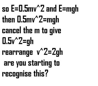

If we want to know how fast an object of any mass will be going when it hits the ground after being dropped we can say that by the time it has fallen distance h it's kinetic energy will be equal to the gravitational energy it has lost because energy is always conserved.
so E=0.5mv^2 and E=mgh
then 0.5mv^2=mgh
cancel the m to give 0.5v^2=gh
rearrange v^2=2gh
are you starting to recognise this?
It turns out to be V^2=U^2 +2gh if we include an original velocity up or down at the time it was dropped. Remember g is acceleration and h is displacement, we've produced V^2=u^2 +2as from using energy and gravity!!!
