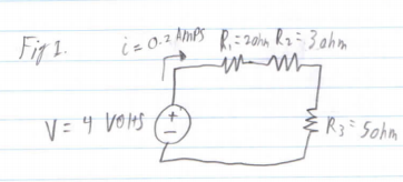

a fundamental skill. Before beginning this instructable it is important to note the three main aspects of a circuit, current (I) how much physical electricity is running through each wire, measured in Amps, potential difference, aka voltage (V) measured in Volts, essentially the potential a circuit has to push electricity through the wire(s), and total resistance (R), measured in Ohms, how much is the circuit resisting the flow of electricity. An entire circuit is shown in Fig. 1 with each part labelled. Through this intrsuctable you will learn how to solve for the total resistance of a circuit and then by using Ohm’s Law (I=V/R) to solve for the current (I) that a circuit will use.

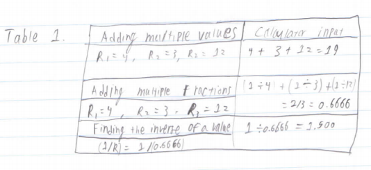

This instructable requires the basic knowledge of algebra along with the ability to use a calculator to solve algebraic equations. At Table 1 you can find tips for calculating the math values required in this instructable.

The voltage of a circuit is displayed by the symbol found in
Fig. 1. You can simply transcribe this value and keep it until we are solving for current (I) in Step 3.

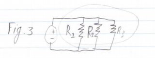

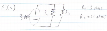

Parallel resistors look like a “ladder” on a circuit, each one is stacked on top of each other so to speak. This is illustrated in Fig. 3.

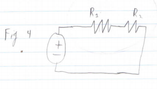

Series resistors look like a “string” on a circuit, each one is placed end-to-end in a row, all traveling in the same direction. This can be seen in Fig. 4.

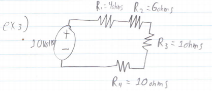

To find the total resistance of a series configuration, you simply add them together. For example, if you have three resistors R1, R2, and R3, the total resistance is as such “R=R1+R2+R3”. This is illustrated in Fig. 5.

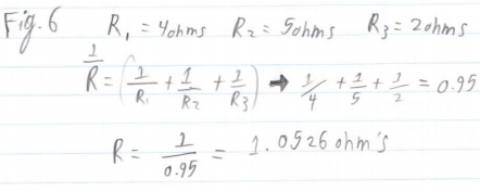

To find the total resistance of a parallel configuration, we must divide one by each resistor value separately, add them together, then divide one by this total. Such as (1/R1 + 1/R2 + 1/R3) = 1/R => R=… This is illustrated by Fig. 6.
If you would like assistance with how to type this values into a calculator, please see Table 1 at the end of this document.

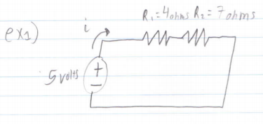

we plug it into the Ohm’s Law equation (I=V/R). For example if our voltage was 5 Volts and our resistance was 10 Ohm’s, then our current (I) would be 5/10 Amps, which is equal to 0.5 Amps. Please see Fig. 7 for an illustration of this method.

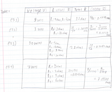

Step 4: Try It for Yourself

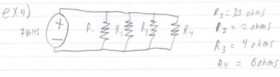

As seen in Figures 8-12 there are four circuit examples.
Feel free to try each example while going through this instructable. The correct values for each example are found in Table 2.
