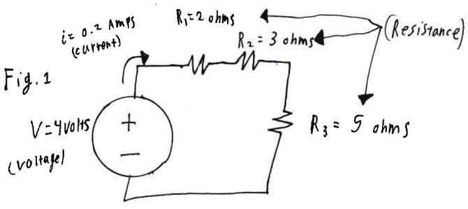

When it comes to electrical engineering, solving circuits is a fundamental skill. Before beginning this instructable it is important to note the three main aspects of a circuit, current (I) how much physical electricity is running through each wire, measured in Amps, potential difference, aka voltage (V) measured in Volts, essentially the potential a circuit has to push electricity through the wire(s), and total resistance (R), measured in Ohms, how much the circuit is resisting the flow of electricity. An entire circuit is shown in Fig. 1 with each part labelled. Through this instructable you will learn how to solve for the total resistance of a circuit and then by using Ohm’s Law (I=V/R) to solve for the current (I) that a circuit will use.

The voltage of a circuit is displayed by the symbol found in Fig. 1. You can simply transcribe this value and keep it until we are solving for current (I) in Step 3.

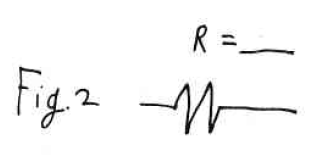

A Resistor is a small component of a circuit used to change how much resistance is within the circuit. It is illustrated as such in Fig. 2.

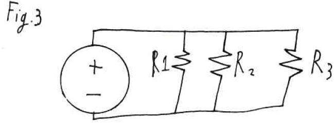

These resistors can be organized in two basic ways, either in parallel or in series. Parallel resistors look like a “ladder” on a circuit, each one is stacked on top of each other so to speak. This is illustrated in Fig. 3.

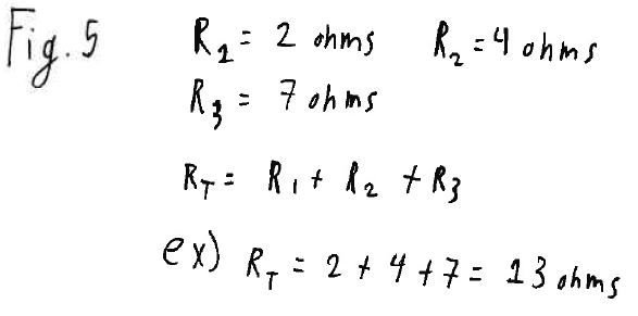

To find the total resistance of a series configuration, you simply add them together. For example, if you have three resistors R1, R2, and R3, the total resistance is as such “R=R1+R2+R3”. This is illustrated in Fig. 5.

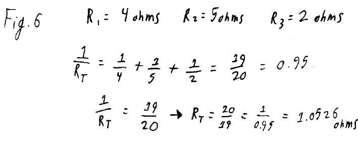

To find the total resistance of a parallel configuration, we must divide one by each resistor value separately, add them together, then divide one by this total. Such as (1/R1 + 1/R2 + 1/R3) = 1/R ==> R=___. This is illustrated by Fig. 6.

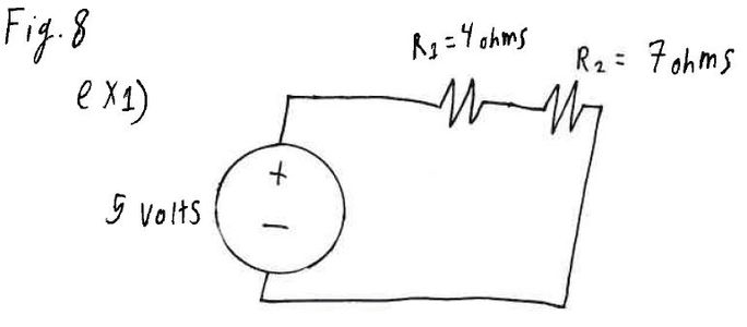

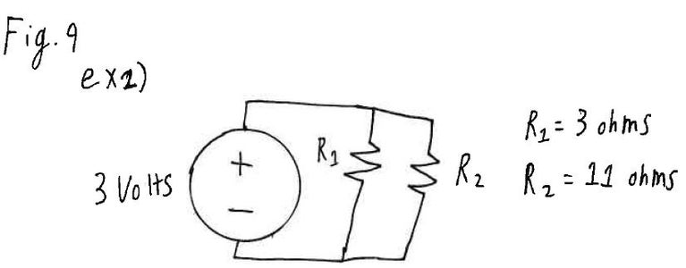

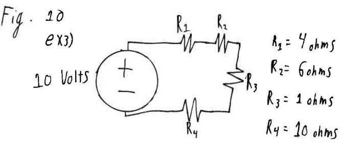

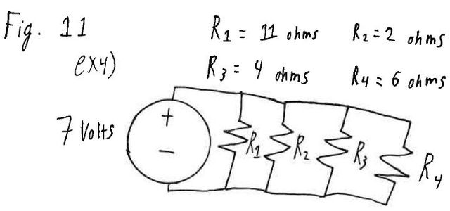

As seen in Figures 8-11 there are four circuit examples.

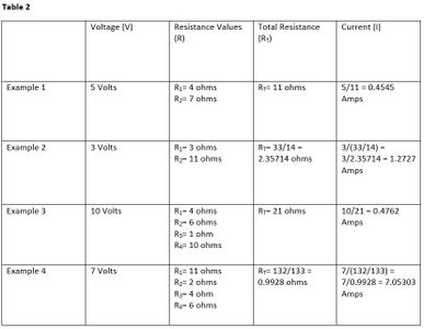

Feel free to try each example while going through this instructable. The correct values for each example are found in Table 2 below.
