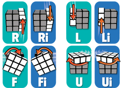

It’s important to understand how the cube is manipulated before you begin to solve one. If you’ll notice, each side of the cube has a certain letter designated to it. F: Front Face. R: Right Face. L: Left Face. U: Up Face. A combination of these face moves will allow us to solve certain steps of the cube easier; these sets of moves are called algorithms.
Notice that there is a difference when rotating a face clockwise versus counterclockwise. For example, let's use the F face (Front Face). If we turn that face clockwise, it's considered to be F, but if we turn it counterclockwise, it's considered to be F' (Pronounced "F Prime"). The added apostrophe, for any face, delegates that move to mean a counterclockwise rotation on its face. Don't forget that L is a clockwise rotation on the Left Face (Therefore the Left Face will turn towards you) and R is a clockwise rotation on the Right Face, but turns away from you. In the picture, the counterclockwise rotations are designated with an 'i' after. This is the same as an apostrophe, and means the same thing.

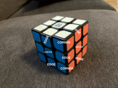

Lastly, there are three types of pieces on the 3x3 cube; corner pieces, edge pieces, and center pieces. Remember that center pieces NEVER move.

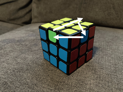

To begin, look for white EDGE pieces. These edge pieces will have another color with them. Match the white EDGE piece with the white CENTER piece, as well as the color it's matched with and its CENTER piece. Figure 2 shows what a matched up white EDGE piece looks like.
Figure 2 shows the matching of a White/Red EDGE piece with the White/Red CENTER pieces.

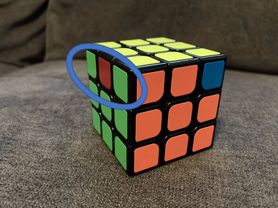

Figure 3 shows the matching of a White/Orange EDGE piece with the White/Orange CENTER pieces. This second example of matching is provided to show that the White/Green EDGE piece is MESSED UP when you match the White/Orange together. It's important to fix the White/Green EDGE piece after you insert the White/Orange EDGE piece in the correct space.

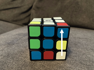

First off, look for the White CORNER pieces. Once you've found one, bring it to the bottom row of the cube. Remember, the White CENTER piece/side should still be on the top of your cube/face.
Bring the corner piece to the bottom row and place it underneath the spot it's supposed to go. Don't forget to correct any White EDGE pieces that you put in place from Step 2 (White Cross). There are three different algorithms that may be needed, depending on how the White CORNER piece is configured.
If you're White CORNER piece is configured as shown in
Figure 1 (White corner is on the right side): D' R' D R
Figure 2 (White corner is on the left side): D L D' L'
Figure 3 (White corner is on the bottom face of the cube. Place it on your right side): R' D D R D D F D' F'

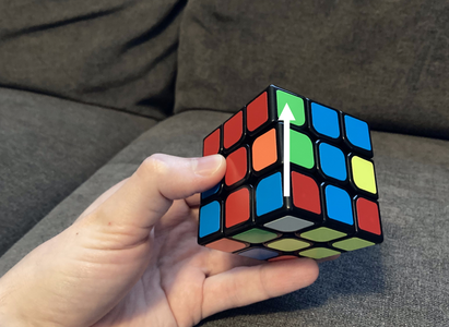

Choose one of those four edge pieces listed (If it's in the top layer) and match the Front Facing color to the CENTER piece. Figure 1 shows a correctly matched Green/Red EDGE piece matching the Red side with the Red CENTER piece.
After the piece is matched up, take a look at the other color on that EDGE piece. In Figure 1, the matching color was Red, and the other color on that edge piece was Green. Take note of the CENTER pieces on the left and right faces of the RED CENTER piece (They are Blue and Green). Because the other color on the edge piece was Green in Figure 1, the edge piece as a whole needs to rotate to the right/clockwise by 90 degrees, as shown. In other instances, the edge piece may need to rotate counterclockwise and be placed in the left side. Figure 2 shows a counterclockwise example with a Blue/Red edge piece needing to be inserted counterclockwise to match up with the Blue/Red center pieces.
