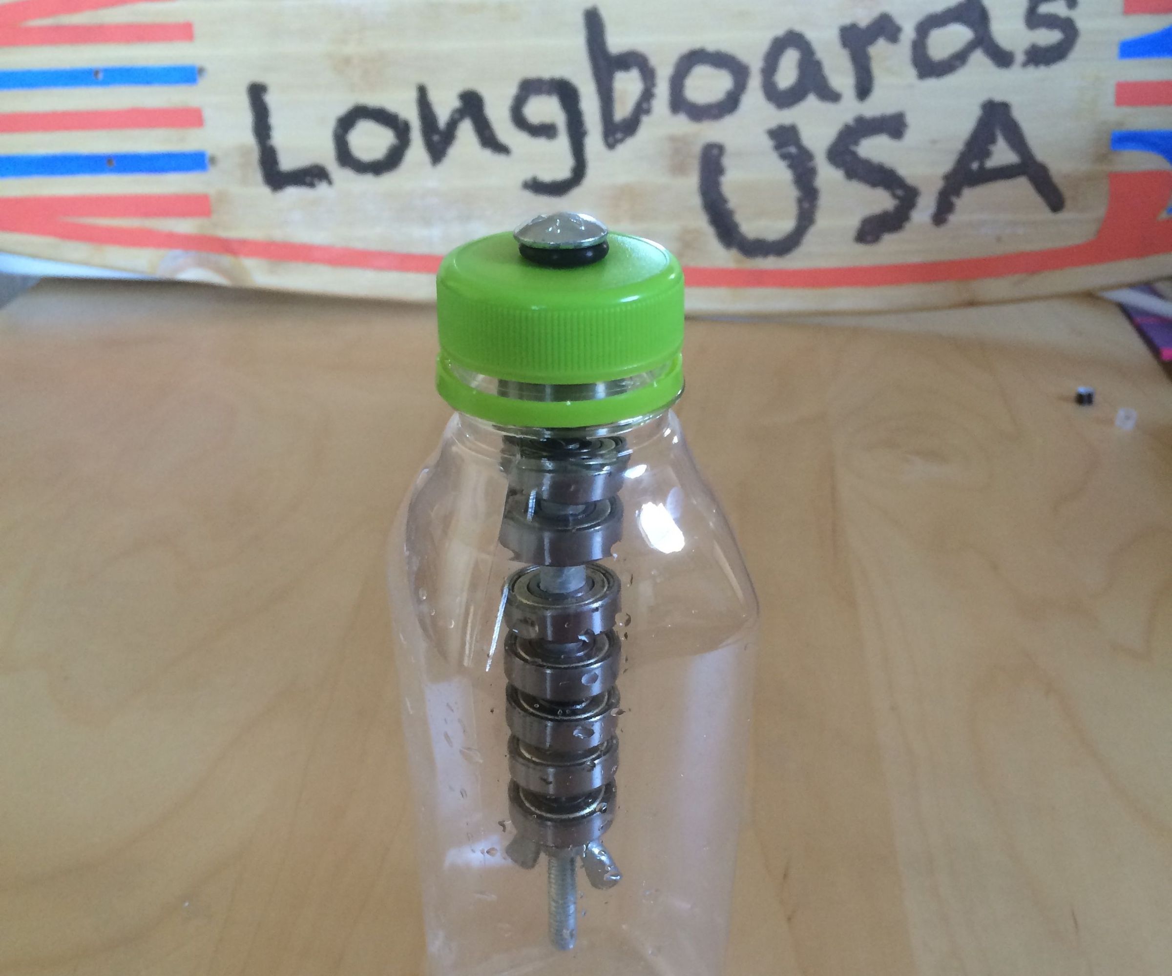

Step 3: Stack Your Bearings Onto the Bolt
Stack up the bearing by alternating spacers and bearings to the bolt of your cleaning kit. At the end add your wing nut.
Step 4: Add Citrus Cleaner
Fill the bottle about a 1/3 with citrus cleaner. Close your bottle with the bearings inside and give it a really good shake. Let it sit for a few minutes and shake it again. Repeat this a few times.
Note: do not use solvents like petroleum, alcohol, spirits or other dangerous cleaners. This will harm your bearings.
