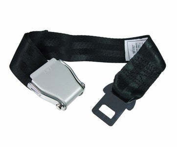

- Seat Belts - Verify that your passengers have their seat belts on and know how to tighten them. In an emergency you might not have time to show each passenger how to tighten their seatbelt.

Step 2: Fasten the Seat Belts
Verify that your seatbelt and your passengers seat belts are all fastened and adjusted properly.
NOTE: As stated in the passenger briefing, make sure your passengers know how to adjust their seat belts on their own.

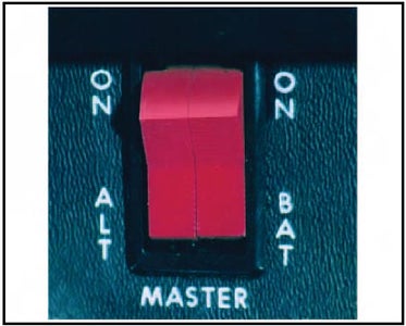

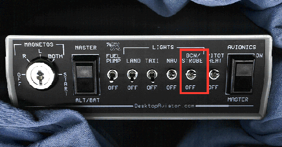

Step 4: Verify Avionics Master Is Off
Some aircraft are equip with a secondary master switch for the avionics. If your aircraft is like this, verify that the avionics master is off.
Having the electronic equipment off is imperative to check prior to engine start. When the engine is cranking, the system has very low voltage. As soon as the engine starts, the starter disengages and the alternator kicks in. This combination causes an electrical power surge that could fry your sensitive electronics.
NOTE: The master switch controls the power to all the electrical equipment. It is normally located on the bottom left of the control panel, where the key for the aircraft goes. In the above picture, it is red. This should also be off.

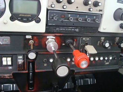

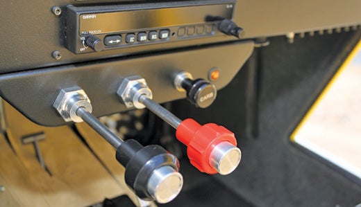

Step 6: Open the Throttle by 1/4 of an Inch
Most small aircraft will have a throttle as shown by the black knob connected to the push-pull rod in the image above. The color will almost always be black, sometimes however the throttle will be white (in older aircraft).
To "open" the throttle by 1/4 inch, pull the knob all the way out and push it back in about 1/4 of an inch back in.
Step 7: Set the Mixture to "Idle Cutoff"
This is a fancy way of saying "pull the mixture knob all the way out" to cutoff the flow of fuel to the engine. The mixture knob should already be in this position, but this step is to verify that. In the picture above, the mixture knob is (and always will be) red.

Step 8: Turn the Master Switch On
Flip the master switch into its on position. You should hear the satisfying hum of gyro's spinning up as soon as you do this.
NOTE: Avionics equipment should NOT be on at this point. Radios, GPS units, etc. should all be off. If they turn on, manually turn them off individually.

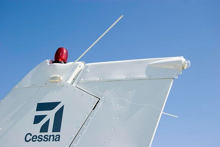

Step 9: Turn on the Flashing Beacon
The beacon that is located on the top of the tail of the aircraft should be controlled by a switch somewhere in the cockpit (every place is different on this). Most pilots leave this beacon on all the time and can omit this step as the beacon will come on with the master switch.
NOTE: It is good to verify that the beacon is on because it indicates to other people outside the aircraft that you will be starting your engine soon and to stand clear.
Step 10: Push the Mixture in to Full Rich
Remember that red mixture knob that we wanted to be at "cutoff" before? Now it should be placed in the "Full Rich" position by being pushed all the way in. This will allow fuel to flow into the engine.
Step 11: Verify the Carburetor Heat Is Cold
The carburetor heat control is normally a push-pull rod. If your aircraft is equipped with carburetor heat, you will want it to be set to "cold" (which is the off position, pushed all the way in) for engine start.
Pulling the carburetor heat knob all the way out will allow the carburetor to use hot exhaust air as intake which will lower your engine performance, but will stop the carburetor from icing over in certain situations.
NOTE: In the image above, the carburetor heat control knob is the knob furthest to the left. Yours will likely look similar

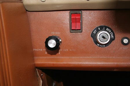

Step 12: Pump the Primer 1 to 5 Times
Depending on how cold your aircraft is as well as how easily it normally starts, you will want to prime it 1 to 5 times by pumping the primer. You do this by pulling out the primer slowly, and then pushing it back in (again slowly).
The primer atomizes fuel directly into the cylinder heads making the aircraft start easier.
NOTE: The primer knob is usually equipped with a locking mechanism. To unlock it, turn it until it pops out a little, then you can begin pumping it. Lock it when you finish.
