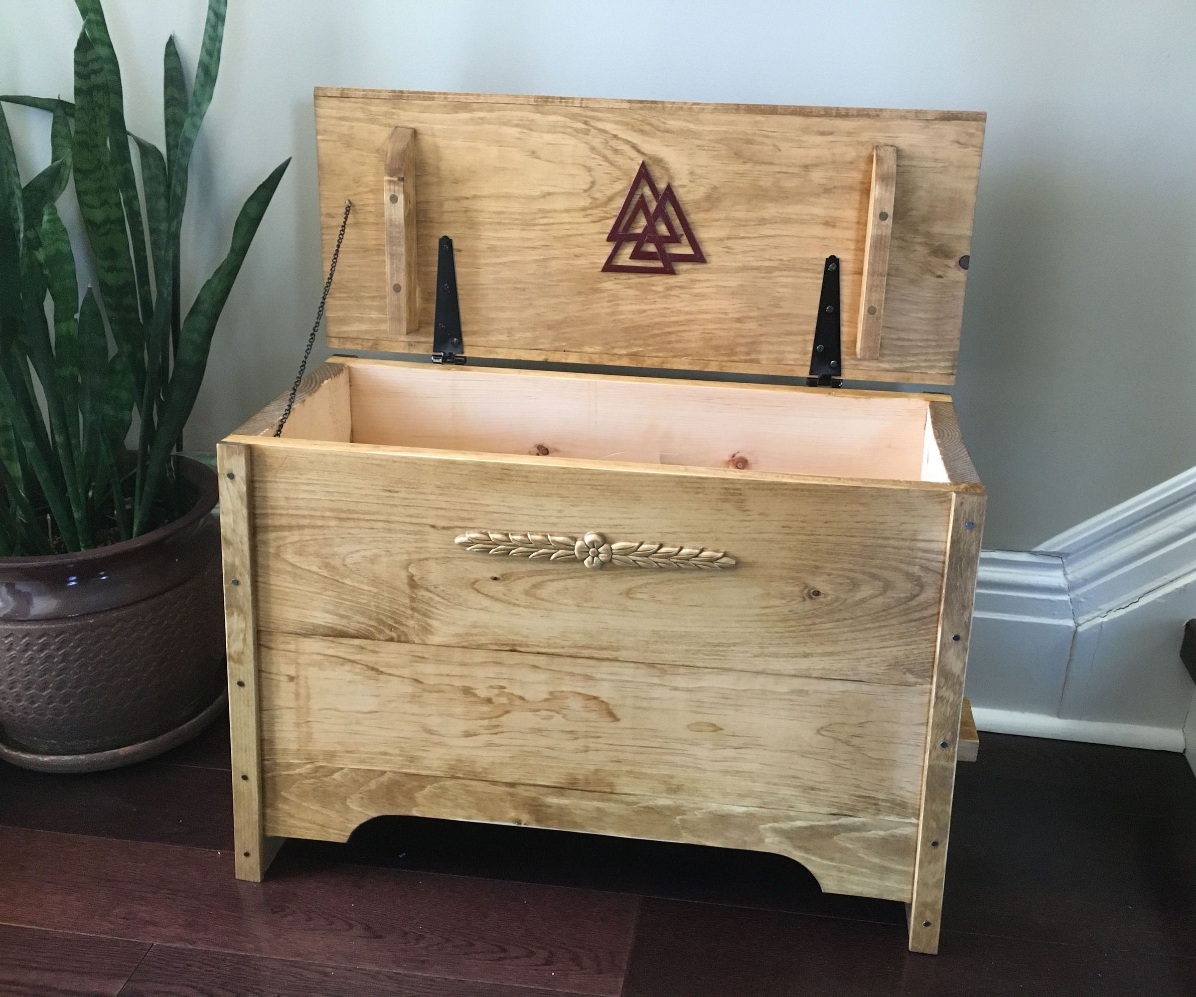

Step 5: Tongue Battery and Storage Box
Tongue battery and storage box
The basic box was built last summer from 3/8" plywood for the front, lid and back panels. The base was cut from a used piece of 1/2" ply. The sides were 3/8" cedar veneer ply. As you can see, the top and front face were covered with aluminum sheeting (from a piece of fascia flatstock). During the winter I trimmed it out by adding oak strips over the aluminum sheeting, copper corner brackets and a few decorative brackets for the front face. They were cut on the bandsaw. The replicate license plate was from a local flea market. The lid is currently secured using a bungee cord.

The galley has had the wannigan (chuckbox) added which holds cooking related items and also serves as a picnic box. The link for constructing the wannigan is here . A few other steampunk inspired items include the lantern and decorating the cabinet doors. I added a cotter pin to the hatch supports to safely secure it in place.

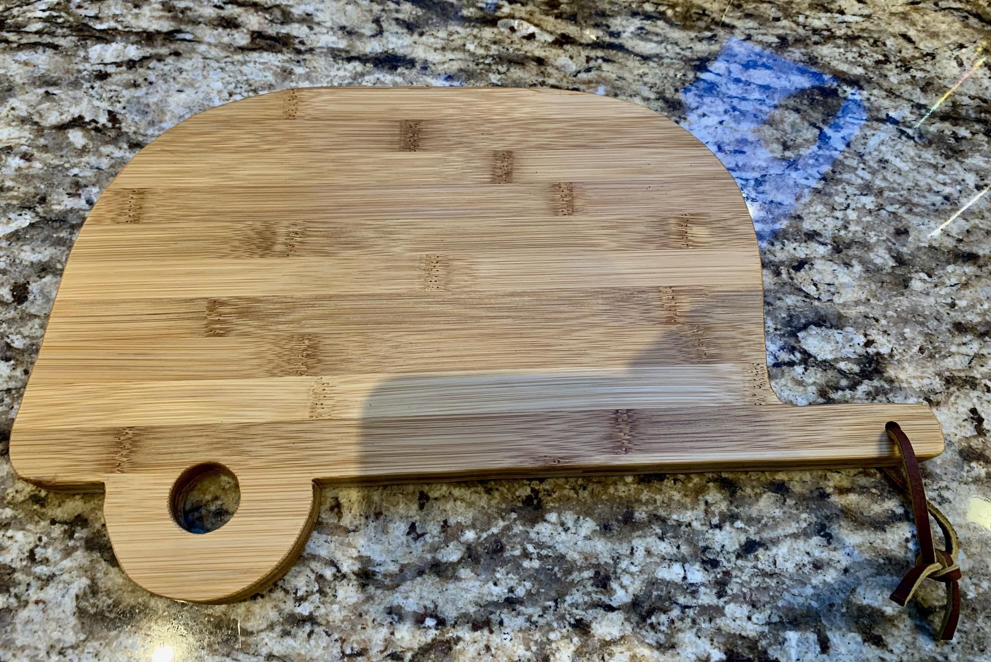

Perhaps the galley needs a teardrop inspired cutting board. One of those projects you can always be working on.
