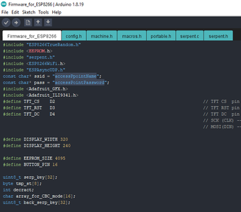

Step 5: Modify Firmware
Open the "Firmware_for_ESP8266.ino" file from the "UDP Image Uploader with Serpent Encryption Algorithm in CBC Mode\Firmware_for_ESP8266" folder and replace my access point credentials with yours.
Step 6: Flash ESP8266
Upload the modified firmware to the ESP8266.

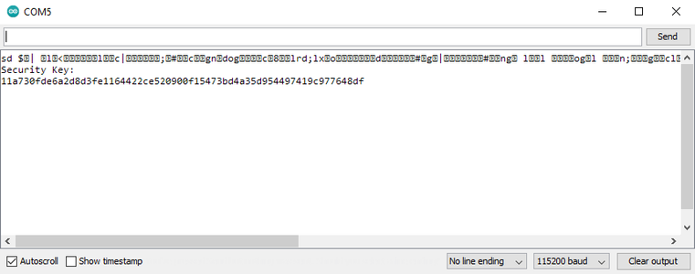

Step 8: Get Security Key, IP Address, and UDP Port From ESP
The software on your PC needs the security key so it can encrypt an image for the ESP8266. To get the security key from the ESP8266:
  1. Connect ESP8266 to your computer;
  2. Open the Serial Terminal with the baud rate 115200;
  3. Hold the button connected to the D0 pin of the ESP8266, and reboot the ESP8266;
  4. Once you see the "ESP8266 will generate a security key and print it to the Serial Terminal in 5 seconds" inscription on the display, you can let go of the button.
Note that the security key is only printed to the Serial Terminal at the moment of its generation. If you lose the security key, you'll have to generate a new one.

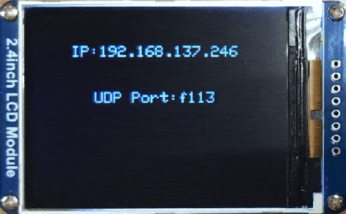

The IP address assigned to the board and the UDP port on which the board is listening will be displayed on the LCD as soon as the board connects to the access point.
To make ESP8266 listen for packets on a different UDP port, hold the button connected to the D0 pin after ESP connects to Wi-Fi and reboot the board to apply the changes.

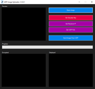

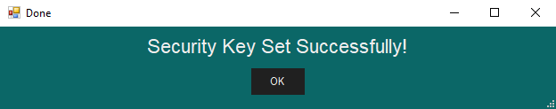

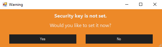

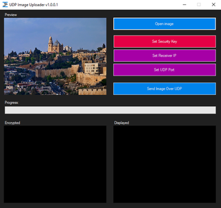

Step 9: Launch the Software and Set Security Key
Launch the "UDPImageUploader.exe" file from the "UDP Image Uploader with Serpent Encryption Algorithm in CBC Mode\Software\bin\Release" folder.
Click "Yes" in the pop-up window. Paste the security key into the text field and press "Continue".
Step 10: Set Receiver IP
Click the "Set Receiver IP" button, then paste the IP address displayed on the LCD with ILI9341 into the text field in the pop-up window, and click the "Continue" button.

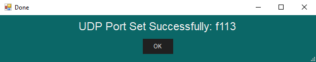

Step 11: Set UDP Port
Click the "Set UDP Port" button, then paste the UDP port displayed on the LCD with ILI9341 into the text field in the pop-up window, and click the "Continue" button.

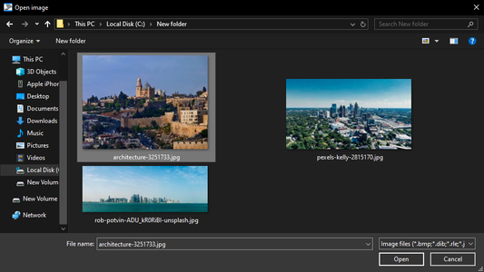

Step 12: Load Image to Software
Click the "Open Image" button, navigate to the image you'd like to send to the ESP8266, select it, and click the "Open" button.
Or you can drag and drop the image to the "Preview" picture box instead.
Step 13: Send Image
Once you have set up the necessary variables and loaded the image to the picture box, hit the "Send Image Over UDP" button to start the uploading process.
It takes roughly 82 seconds for the image to be encrypted, sent, decrypted, and displayed.
