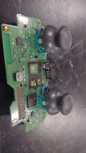

When you separate both sides, we will focus on the side with the battery and all the electronics. Taking off the battery is easy; it simply pulls out of that small, black, pocket it is in. After that, I unscrewed the screw in the motherboard. I thought this was going to be all I needed to do in order to take out the motherboard. This is where the soldering iron is required.
There are 4 wires soldered onto the board, 1 black and 1 red wire on each side. These are responsible for activating the "rumble" effect on your controllers. I just pulled them off, it was incredibly easy, no damage done to the board or the wires themselves. After you detach the wires, then the Motherboard is able to be separated from the controller.
The joy cons are connected to the motherboard, so when you see them coming off the controller when you take off the motherboard, don't be as shocked as I was. I was able to take out the motherboard and I tried to just clean the joy cons with a Q-tip and some rubbing alcohol. It normally does the trick with my N64 controllers.

I was incredibly invested with the inside of my controller at this point. So, I kept taking off different parts. Be warned, the small orange cord thing is an annoying thing to put back, so if you keep deconstructing it can be put back, but it may drive you a LITTLE insane :).
There is a different type of electricity board under the motherboard. I assume it is responsible for sending the signals from pressing the controller's buttons, to the motherboard. I took of the plastic part of the controller, not messing with the blue and grey circuit board. I loved how it has different wires for each button. I was amazed by everything. Under this plastic part, is the topside of the controller, with the buttons. If you would like to remove the buttons to see them and the way they look, it is really easy to do. I would do this in a clear environment because a couple of these buttons are really easy to misplace.
Before I took out the buttons though, I wanted to look at the piece that has the orange stripe. I took it out of the controller and realized it is the touchpad. So, I REALLY wanted to see the computer chip/circuit board running it. It was easy to take off, I saw the computer running it and noticed it doesn't look like anything I've seen before. I wonder how many types of circuit boards/motherboards there are in electronics.
