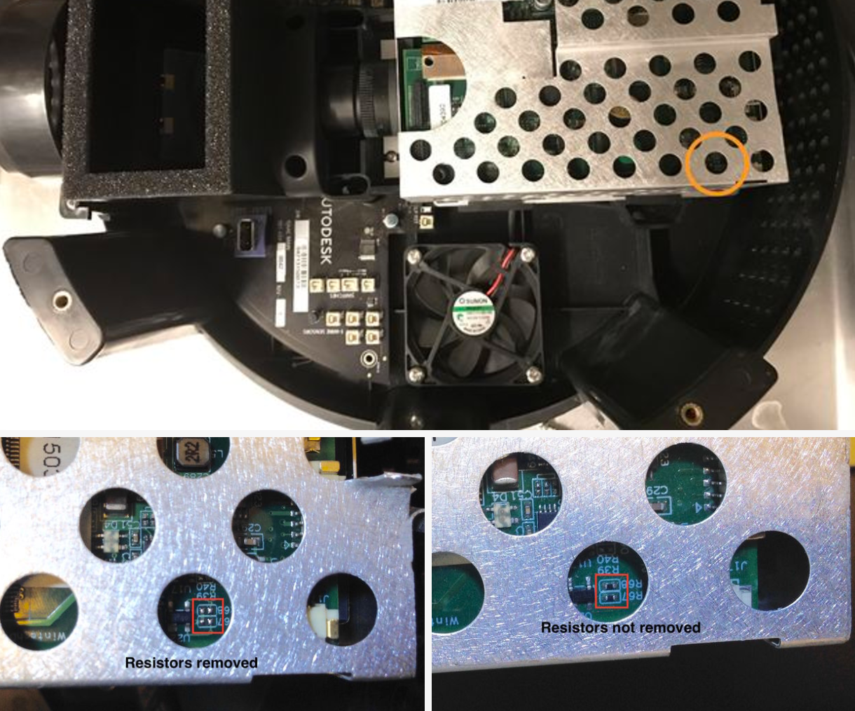

Step 9: Optional: Remove the Ember Focus Locking Screw
Most Embers have a screw that locks the focus of the projector so it doesn't change during transport. However, you may want to refocus your projector. If that's the case, remove the locking screw (circled in orange) with a Phillips screwdriver.
To focus the projector, use a 2.5mm hex key to turn the focus screw at the back of the machine above the power and ethernet ports.
If your projector still isn't focusing sufficiently, you can change the focus as much as you want by unscrewing the lens barrel. This requires removing the plastic housing over the lens barrel (2 screws) and loosening the knurled ring around the lens (sometimes requires pliers). Note that there are two lenses; you want to rotate both of them as one unit, not just the front one.
Interesting note: if you unscrew the lenses enough, you can actually double the resolution of the projector. However, the trade-off is that the build area is 4x smaller, and the focal length is only a few centimeters, which means that you have to point the projector directly up into the window, which requires building a custom lower enclosure to hold it.

To remove the projector EMI cage,
