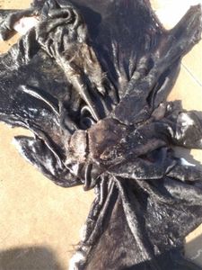

Step 8: Apply Tanning Oil to the Hide
Applying the tanning oil:
  • Using the oil provided in your tanning kit, rub oil all over the hide.
(Be sure to massage into the hide and coat generously)
  • Leave tanning oil on hide for one week
  • Add more oil if necessary for the first few to keep the hide from drying out
  • After the fourth day let oil dry and soak into the hide
Step 9: Once Oil Is Soaked in Work Hide to Make It More Pliable
Once your oil has soaked in, you are ready to work with your hide. Cow hides are very thick so it will be pretty stiff. Take time to work with your hide and it will become pliable.
  • Fold, bend, and crease the hide to make it workable
