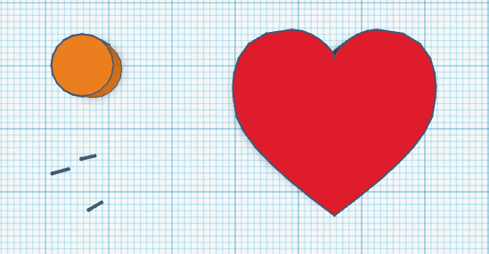

So make the basket. We've used a cylinder directly from the Tinkercad library. We are going to use it as the base for the basket of the hot air balloon (which is going to carry people).
So drag a cylinder from the library onto the workplane, and adjust its colors and size accordingly.
Now that we have created the base of the basket, we are going to add the wires that are going to connect the basket to the balloon. For this, I have used 3 identical cylinders whose radii have been decreased to make them look like a rope. After we are done with adding a rope, we can duplicate(ctrl+D) it to make more. Now place them on the cylinder.

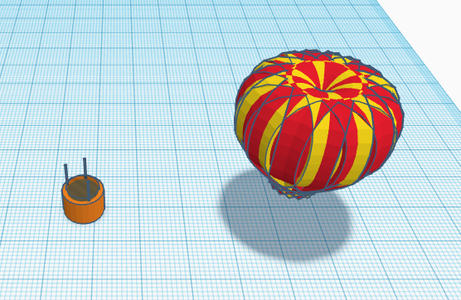

So now, to make space in the basket, we are going to use a hollow cylinder to make a hole. As shown in the above image, take a hollow cylinder and place it in the middle of the base we made before.
Voila! Our Part I is completed. We have now completed the process of making the basket for the hot air balloon.

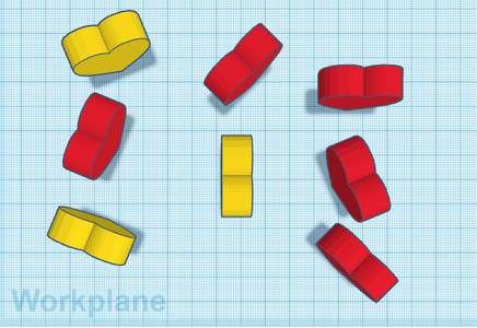

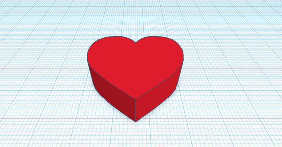

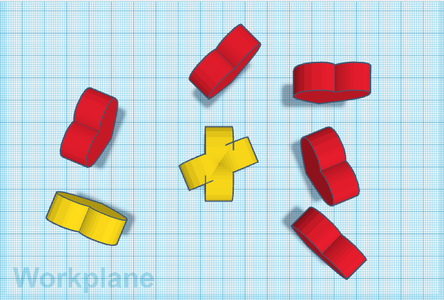

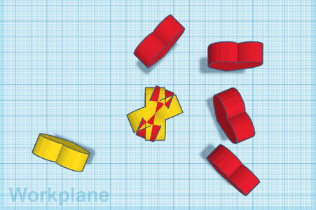

So, to start with part 2, we are going to take a heart shape from the Tinkercad library and place it on the workplane. Make it vertical by rotating it 90 degrees. Now we are going to duplicate (ctrl+D) the hearts. In the image above, I took:
- 3 Yellow hearts
- 5 red hearts
Such a beautiful model is just made by rearranging hearts. How cool is that?
Now that we have the hearts ready, let's get into arranging them.
Step 6: Arranging the Hearts

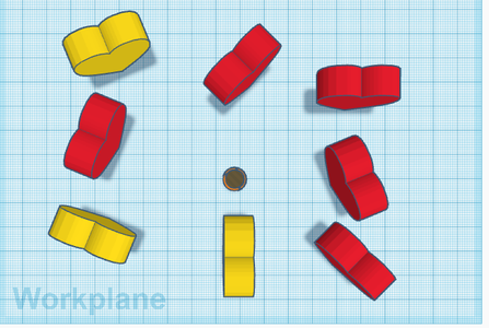

Our hearts will now be arranged into a pearl-like structure once we have them ready. To accomplish that, each heart will be rotated at a different angle until it forms a circle. I'll list the angles I used below. By making the hearts' angles smaller, you can use more colors and hearts if you like.
To select an angle I calculated n/180, where n is the quantity of used hearts. My situation had a 22.5-degree differentiating angle. which indicates that my heart rotated by
- 0 degrees
- 22.5 degrees
- 45 degrees
- 67.5 degrees
- 90 degrees
- 112.5 degrees
- 135 degrees
Even better, you can just rotate the hearts and skip the calculation altogether. Just be sure to cover all the sides.

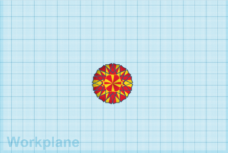

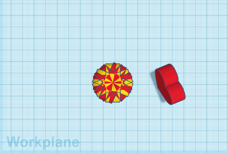

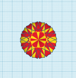

Now that we have completed rotating the hearts, it is time to attach them together to form the balloon. Start with one and start dragging them all on top of each other. Make sure all the hearts have the same center point.
I've attached the image above for reference. While arranging the hearts, make sure that the colors are alternating.

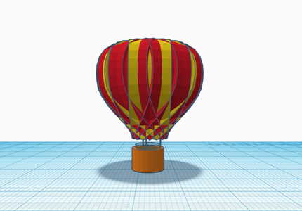

Step 8: Completing the Balloon

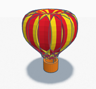

After that amazing step, our balloon has now come into shape. from such a simple shape into a beautiful balloon.
How cool is this?
Now that we have completed our balloon, make sure that you group all the hearts together, making it one object.

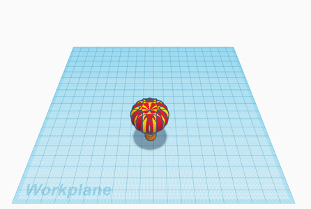

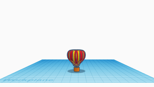

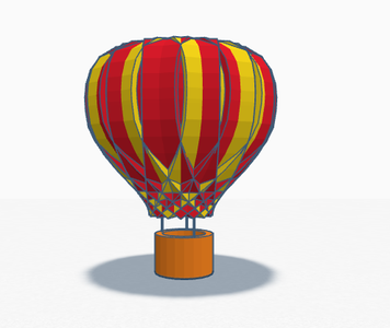

Now that both parts of our hot air balloon are ready, it's time to join them. In order to do that, lift the balloon and place it over the basket as shown. Now group all the objects together.
It's time to fly!
We have now completed making the hot air balloon in just 9 simple steps and with 2 simple shapes.
