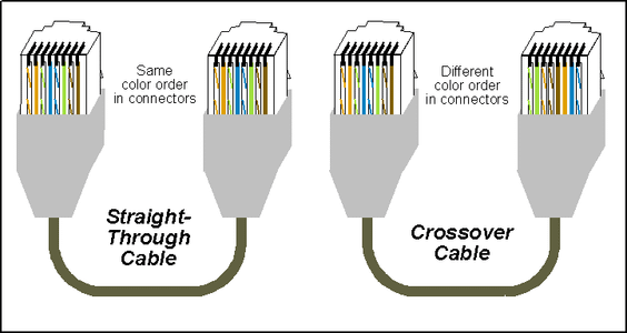

Background: In the Information Technology World, the Ethernet cable has been the most trusted medium that is link computers to the world wide web. However, in recent years, wireless technology has limited the use of the Ethernet cable. Nonetheless, true computer geeks know that in order to receive optimum speed within a computer network in a business or inside our homes; the proper cabling technics are crucial when installing a computer network. Therefore, this instructable will provide step-by-step procedures on the proper way to terminate a CAT 6 cable using the TIA 568B standard for a straight-through cable. The procedures used for the straight-through cable can also be utilized to terminate a cross-over and roll-over cable.
Cable Pin-outs: Straight-Through, Cross-over, and Roll-over cables

Step 3: Align cable wires for the specific configuration that will be terminated
The alignment of the wires will ensure they enter the proper channel within the RJ-45 connector when inserting the wires.

Straight-Through and Cross-over Cable Image: Retrieved from https://melco.zendesk.com/hc/en-us/articles/203779335-Ethernet-Cables-Straight-Through-vs-Crossover-

Step 3: Align Cable Wires for the Specific Configuration That Will Be Terminated
