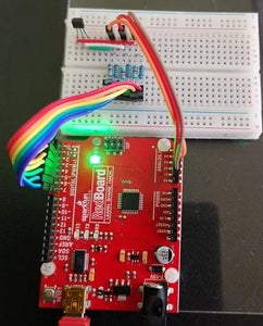

Hardware:
Sparkfun RedBoard or Arduino Uno
Solderless breadboard
Wires suitable for breadboard, e.g., Dupont or solid core.
6 resistors: 3 x 1.5K Resistor 1% or better & 3 x 470K Resistor 1% or better
Recommended: Multimeter but not essential.

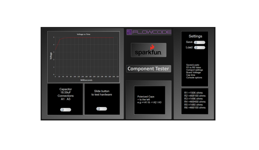

Figure 2. What the App software looks like.
You can find the App developer software and all files for the component tester by clicking on this link.

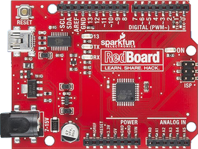

Step 2: Step 2: Loading Firmware Onto the Sparkfun RedBoard/Arduino Uno.
You will need to install the drivers for the RedBoard or Uno.
If running a Redboard, then the SparkFun ReadBoard Hookup Guide will take to though the install process step by step.
If you have an Arduino Uno board then best way would be to install latest Arduino IDE as that has got drivers included.

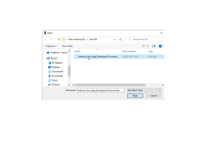

Step 3: Select .hex File
As you might have more than one port assigned, you will need to remember the port number assigned to your RedBoard/Uno
To enable your PC to establish communications, you first load the correct firmware from this link onto the RedBoard.
The only file you will need is called Arduino_Uno_App_Developer_Firmware.hex.
Select the .hex file from within the zip file, then paste into a folder of your choice.

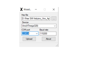

To transfer the above hex file, you will need to download Xloader.
It is very easy to use.
Step 4: ​Extract the XLoader
folder within the zip file, to a folder of your choice.
I just copied and paste the folder from the zip file, on to my D drive.
Run the Xloader app then left-click on the three dots & a new window will open:
Select the hex file as illustrated above, then select open.
The Device is Uno ATmega3280 as that works for both Sparkfun RedBoard and Arduino Uno.
Make sure you have the correct COM port selected.
The Baud Rate is left on the default 115200.
Click on the Upload and the firmware will be sent to the Redboard/Uno.
You will know if being sent as the TX and RX on the PCB will be rapidly flashing during the transfer.
Step 5: Step 3: Wiring Up Hardware.
To make is easier to follow, I have used the conventional
resistor colour code for the RedBoard connections I.e.
Black = 0 (not connected), Brown = 1, Red = 2A, Orange = 3, Yellow = 4, Green = 5, Blue = 6, Violet = 7, Grey = 8 (not connected), White = 9 (not connected).
The values of the six resistors are not critical, just try to get then as near as possible to the suggested values.
The values I used are: 3 x 1.5K & 3 x 470K
Connect wires & resistors as per figure 5.
If you follow the brown wire, you will see it goes to A1
A Red wire goes to A2 and D2 etc.
The A representing Analogue & the D representing Digital.

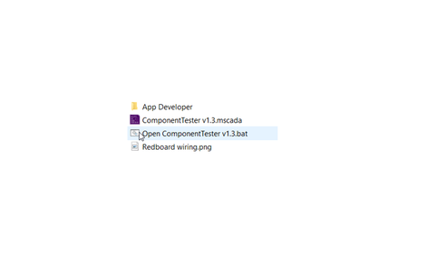

Step 6: Run the Open ComponentTester V1.3.bat
From within the folder you downloaded from step1

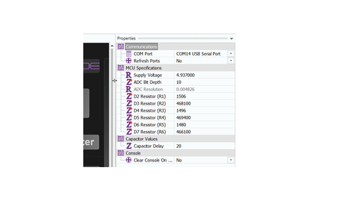

Within the Component Tester App, you will see a Properties
window.
Step 7: Within the Component Tester App, You Will See a Properties Window.
For the Refresh Ports option select Yes from the drop down, it should revert to No.
Select your boards COM port.
The width of the properties can be dragged if too narrow.
Hover the mouse over the left border of the properties, when the cursor changes to two parallel lines, hold the left mouse button down and drag to increase/decrease width.
If you have a Multimeter, with no power going to the board, measure each resistor and enter the value within properties.
When you have finished, Slide the save switch.
That will save a file called config.cfg within the root of App folder.
Step 8: Step 4: Running the App.
With no test component added, select Go.
The wiring can be automatically checked by selecting test hardware switch.
Follow the on-screen instructions.

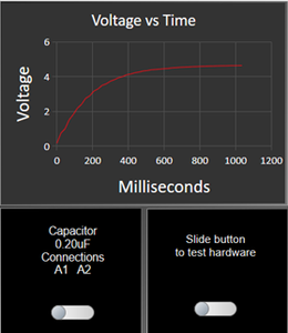

Step 11: Step 5: Component Testing.
Place the component to be tested across any of the connections A1 A2 & A3
For example, here is an image of one of my transistors being tested:
After connecting transistor to A1, A2 & A3, Then sliding the switch on the left, the results are:

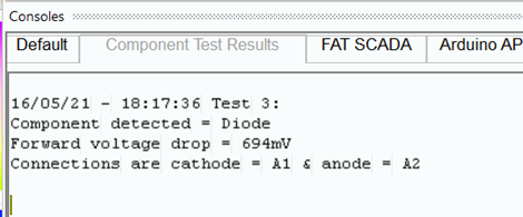

Here are results some other components under test:
Silicon diode:
If you select View, then select Consoles you will see a log of all the tested components:

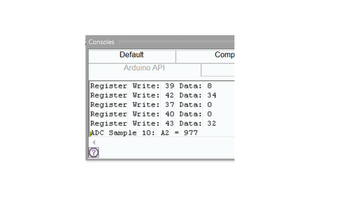

There are two ways of determining if it is a communication issue.
If both TX and RX LEDs are not flashing while App Developer is determining component connected.
Or open the console (View menu, select Consoles).
Undock the console so the App Developer panel can be made larger.
In the View tab, select Consoles tick box.
Select Arduino API tab.
If communication OK, you will see something like the above image.

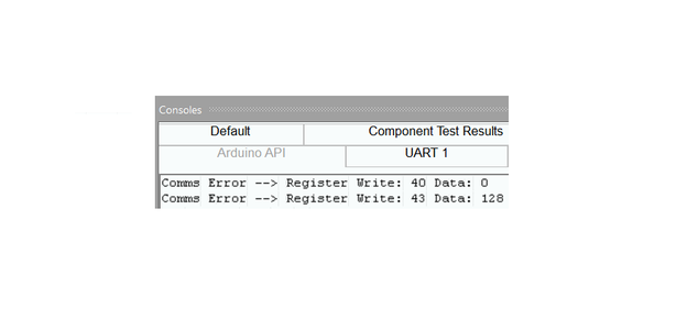

Step 13: If There Is an Issue With Communication or Firmware, Then You Will See:
If it is a communication issue:
Is the correct com port selected within properties?
Has some other software taken over the port?
Is only one instance of App developer run at a time?
Make sure you run the hardware test.
When the hardware switch is first activated, there should not be any additional connections to A1 to A3 on the breadboard.
Then Link A1 to A2 to A3 & Left-click the switch again.
Any issues should be displayed.
