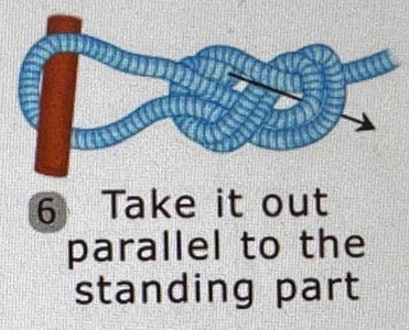

Step 4: Follow the Figure 8 Path
4. Follow the Figure 8 Path
  1. What to Do: Take the working end and follow the path of the original figure 8 knot. Just trace it with the rope, keeping it snug.
  2. Tip: Make sure the rope stays next to the original knot as you go.
  3. Visual(If you are training someone how to do it): Show the rope tracing the figure 8, maybe with arrows to show the path.
Step 5: Tighten the Knot
5. Tighten the Knot
  1. What to Do: Keep threading the rope until you’ve followed the whole figure 8, then pull both ends to tighten it up.
  2. Tip: Make sure the knot is tight and neat, with no slack.
  3. Visual(If you are training someone how to do it): Show the completed, tightened figure 8 follow-through knot.
