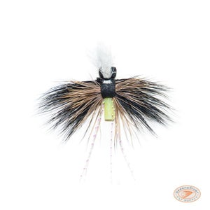

Step 1:
Step 1: Melt a flange on a 1.8mm plastic tube. Insert this 8mm into a 3mm diameter plastic tube. Leave 2mm of the 1.8mm diameter tube sticking out of the 3mm tube. Do not insert any further than this since the rear of the tube needs to be kept free for hook insertion.
Step 2:
Step 2: Create a flange by melting the front of the 1.8mm and 3mm tubes. If needed press the hot flange against a metal surface to press the two tubes together and form a flange.
Step 3:
Step 3: Tie in your thread in front of the bump that is created by the flange of the 1.8mm plastic tube. This further secures the connection between the outer and inner tube.
Step 4:
Step 4: Tie in two strands of UV Shimmer Flash (pearl or yellow). Tie them in so that there are two strands on each side of the tube.
Step 5:
Step 5: Tie in the foam back. Prior to tying the foam in you can slightly taper the foam so that it is wider in the front.
Step 6:
Step 6: Tie in a clump of deer hair just in front of the foam. Take a couple of thread turns while applying tension on the tread to cause the deer hair to spin around the tube. Clip off the butt ends of the deer hair.
Step 7:
Step 7: Tie in the second deer hair wing, right in front of the tie in point of the first wing. Keep the wing slightly longer than the first wing. Clip off the butt ends and clean up.
Step 8:
Step 8: Bring the foam strip forward and tie it down just in front of the second wing. Fold it back, leaving a small "bumper", and tie it in. Pull lightly on the tag end and clip it off close to the tie in point.
Step 9:
Step 9: Tie in a bunch of Kid Goat body hair. Prepare the wing by evening out the tips as much as possible. Take about 10 turns with good tension at the tie in point; this will angle the wing up at a 45 degree angle. Whip finish the thread and apply crazy glue to the thread and wing base in order to stiffen up the wing.
Step 10:
Step 10: Take the fly out of the vise. This top view shows the fly proportions. Note the longer second wing.
Step 11:
Step 11: Cut off the excess tube; cut the tube very short, in-between the wings. This assures that the hook does not sit too far back.
Step 12:

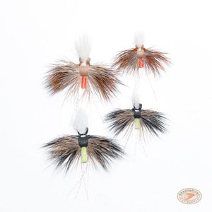

Step 12: The completed Seek & Destroy flies; Top row: Bright Light version for clear/bright conditions. Bottom row: Low Light version for low light/cloudy conditions. Left column are the larger "Seekers", right column are the smaller "Destroyers". Generally I search with the larger "Seekers". If I happen to get a refusal on the "Seeker" I close with the "Destroyer".
