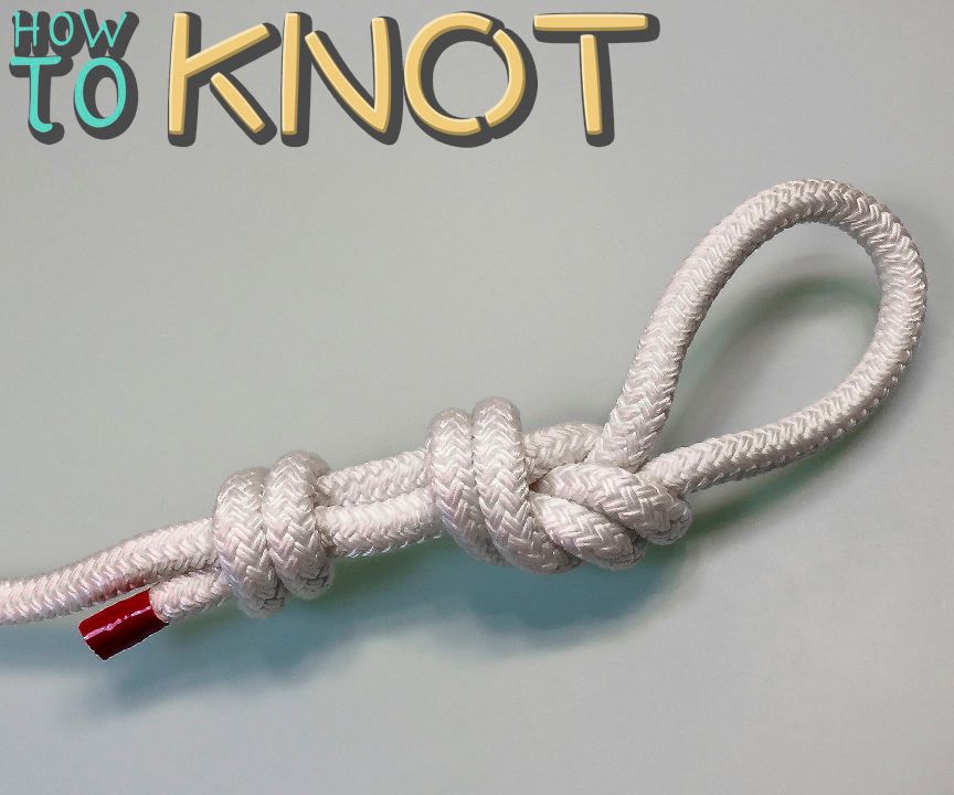

Introduction: How to Tie a Threaded Figure Eight
Welcome to my How to Knot tutorial, I will be showing you how to tie a threaded figure eight. This knot’s intended use is for climbing. A stopper knot can be added as a safety precaution. Once learned, this is a fairly easy knot to tie and is essential for climbers. It’s design is easily distinguished so it can be easily checked during a safety inspection, it can be directly tied to hardware devices, will self tighten under a load, and can absorb some shock. After a load, this knot can be difficult to untie.

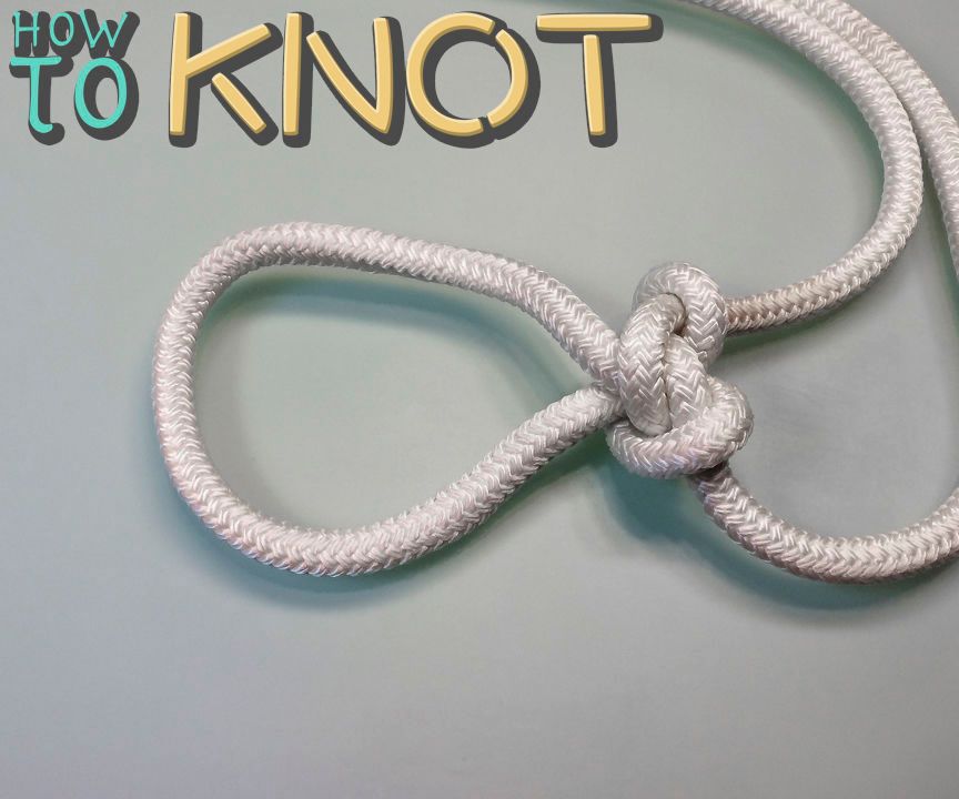

Step 1:
First start by creating a figure eight knot.
Now feed the working end back through the knot.
Follow the same figure eight path while still keeping the loop.
Dress accordingly and you’re done.
