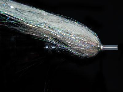

Step 6: The Tapam Special has what is called a “flash tail”; this means that flash material is tied in that extends past the other materials of the fly, so that the tail of the fly is made up of flash material only. Tie in flash material that is 3x to 4x as long as the Snowrunner brush fibres. The flash in the image extends well beyond the image. I like a mix of pearl and silver for this step. The flash is tied in on the upper half of the tube.

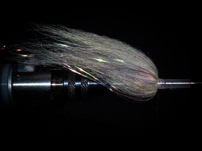

Step 7: Tie in a long wing of Snowrunner. Tie the wing on top of the tube. Tie it down with 3 wraps of thread. With your thumb nail push on the tie in point and distribute the hair over the top half of the tube. Ad some flash.
Step 8: Add Flash
Step 8: Add some additional silver or holographic flash to the sides and upper half of the fly.

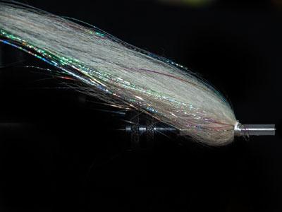

Step 9: Tie in the next wing section of Snowrunner. This section should be the same length as the first wing section. In this case I used a light olive. Ad some flash.

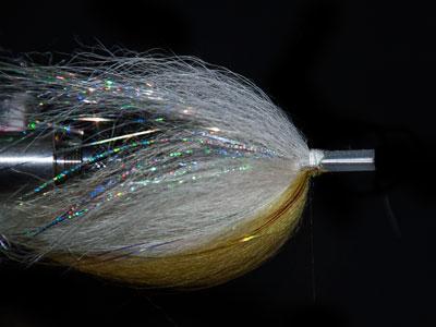

Step 11: Create the 3rd Wing
Step 11: Rotate the vice back. Tie in a bunch of Snowrunner for the 3rd wing section. This bunch should be about half the size of the second wing section and about half the length. At this stage you can take a standard comb and gently comb the pattern in order to blend the fibres, wing sections and flash.

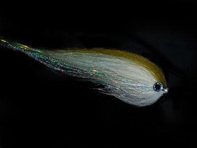

Step 13: The Finished Fly
Step 13: The finished fly. This fly can be tied in any colour combination or size, depending on the target species. Happy fishing!
