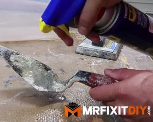

Once you’re finished with your tools, I always recommend you wipe them down with a coat of WD-40. If you don’t do this, your trowels can oxidize as they sit around so next time you go to use them you’ll have to deal with scrubbing off the rust.
If you forgot to clean them off before the mortar has hardened, don’t worry! You can still clean them. Use some WD-40 Trigger Pro to spray on the mortar, and then tap it with a hammer. Then using another trowel or painter’s tool to scrape off the mortar. Then wipe them down with WD40 afterwards.
If you have rusty trowels sitting around, I recommend soaking them in WD-40 Specialist Rust Remover Soak for a while.
Spend the time to keep them in good working order and they’ll last you for many more jobs to come.
