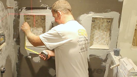

Step 6: Laser Level the Sill
Okay, this is where tools come in handy.
Use a laser level to ensure the sill tile is level.
If you're tiling two niches, a laser level is a must as it will help keep all the tiles level with each other.
Step 7: Make the Sill Proud
The sill tile should hang outside the niche by 1/16" if you'll be using pencil trim tile to frame the niche.
As you can see in this picture, Steve is using 12x24" wall tile that's the same thickness as the sill.
By making the sill stick out by 1/16" he'll make the pencil tile hang out over the main tile by the same distance.
It adds a picture frame look that's more aesthetically pleasing to the eye...yes, this is super important if you want your tile to look good.
Step 8: Level Each Sill
Use the laser level to ensure both sill tiles are level with each other.
Step 9: Embed Tile Mosaic
Embed the tile mosaic by hand then embed them fully in the thin-set with the grout float.
Some thin-set will ooze out of the grout joints. Just remove it with a carpet knife (be careful not to pierce your waterproofing) and damp sponge.
You can cut tile mosaics with either a tile wet saw or tile cutter.

Step 12: Level the Top Tile
Use your laser level to ensure the top tiles are level with each other.
