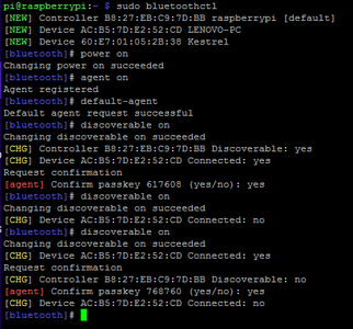

Step 2: 1.2. Make the RPi Discoverable Using Bluetoothctl (Bluetooth Agent)
This the first of our two RPi putty sessions, is the RPI Bluetooth Agent window (bluetoothctl),
Using Putty, log onto the command line of the Rpi then type
sudo bluetoothctl (This opens a new shell)
When I do this it displays the visible Bluetooth devices, e.g.
[NEW] Controller B8:27:EB:C9:7D:BB raspberrypi [default]
[NEW] Device AC:B5:7D:E2:52:CD LENOVO-PC
[NEW] Device 60:E7:01:05:2B:38 Kestrel
I am interested in the address of my laptop, AC:B5:7D:E2:52:CD
Next
Typepower on
Displays Changing power on succeeded
Type agent on
Displays Agent registered
Type default-agent
Displays Default agent request successful
Type discoverable on
Displays Changing discoverable on succeeded
[CHG] Controller B8:27:EB:C9:7D:BB Discoverable: yes
[CHG] Device AC:B5:7D:E2:52:CD Connected: yes
Keep this putty session open

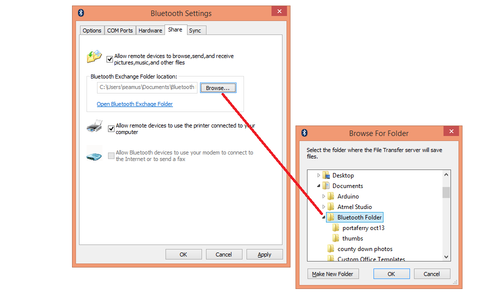

Step 4: 2.1. Set Up a Shared Bluetooth Folder

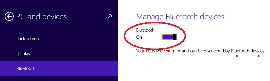

Turn Bluetooth on on your laptop-
To see if blue tooth is activated on the laptop - swipe the screen to reveal the settings link, then select change PC settings, then click on PC settings. You will see the button to turn Bluetooth on.

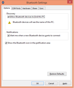

Next, go back to the desktop and click the little arrow on the bottom right toolbar to reveal the bluetooth icon. Click on this and select open settings. Select the "Share" tab and you can see the Bluetooth Exchange folder location and then on the click the "Allow remote devices.... " box.
Go to the Options tab and check the box that allow other Bluetooth device to find or discover this computer. When pairing is complete, remember to go to your Bluetooth Device’ Options tab and uncheck the box that allow other Bluetooth device to find or discover this computer. That’s means only your computer can discover other Bluetooth device, so that can avoid your computer from discovered by other unknown Bluetooth device.

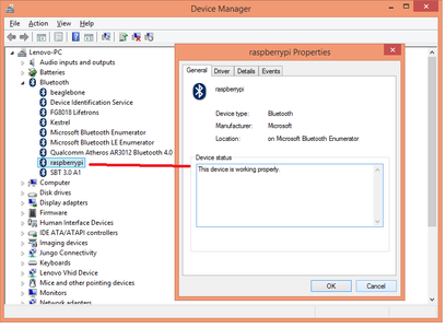

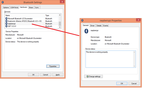

Step 5: 2.2. Discover the RpI and Pair With It From the Laptop
Again, on the laptop, swipe the screen to reveal the settings link, then select change PC settings, then click on PC settings. You will see the list of available bluetooth devices. Remember that for the RPi to be visible you will have to make it discoverable from the RPi putty screen (bluetoothctl) and similarly, on the Bluetooth Device options tab on the laptop.
Still on the laptop, next click on the RPi pair button and then go to the RPI putty session (bluetoothctl) and you will asked to confirm the passkey (Confirm passkey xxxxxx (yes/no): yes) Remember to to type yes -
Then flick back to the Laptop bluetooth screen and likewise, click to select. It should tell you that the RPi is connected to the laptop.
(Note, that from a security perspective, the passkey should not a default, eg 1234, and if it is, don't accept it. Also, ensure that both the RPI and Laptop are no longer discoverable)
