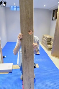

The top comes courtesy of leftover scraps of wood flooring we kept after finishing our basement. You can read all about our engineered hardware flooring installation here if you're curious to see where these scraps came from. But you can see Hubs having fun with the installation in the second picture. If you have leftover flooring, this Instructable will show you how easy it is to repurpose it as a top!

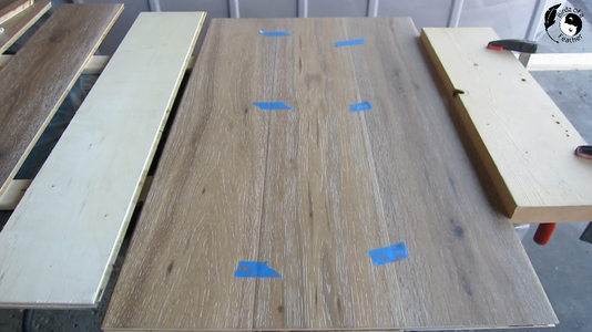

I’m building the top with the same glue we used when we originally installed our flooring. Again, we're using our leftover 'scraps' which is great because it's made specifically for the flooring.
Clamp a deeper board onto one end of the table. This will act as a stop so you have something to work against. Place the first board against the stop with the tongue facing it. Then turn the next board with the groove facing up and squeeze the glue into the groove of the plank. Be sure to get even coverage of the glue.
Slide the now-glued plank against the first board. Use a piece of cut-off from the flooring to hammer against the edge with a mallet. The cut-off will prevent accidental damage to the board.
We don't have clamp long enough to clamp the flooring together so we do what the manufacturer suggested when we laid the floor in our basement. Take pieces of blue tape and run them across the seams. The blue tape stretches and will help keep the planks together as they dry. With this particular glue, if any squeezes out, let it dry slightly first, then you can peel it right up. But if you let it dry too long, it will be there permanently so don't forget to do that step!

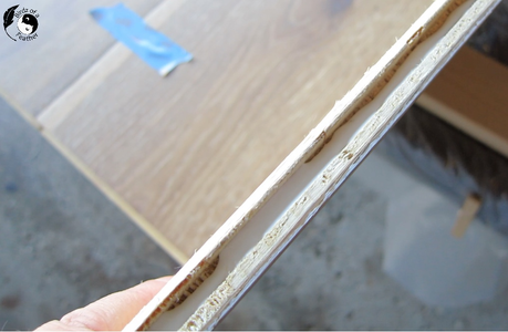

Once the glue dries, our boards are 72" long so will need to be cut down to fit the base.
We’re using a circular saw to cut, and want the edge as smooth as possible, so we’re switching to an ultra fine blade.
If you want to keep the boards their full width (which we do), measure the width of the plate on the saw to determine where to clamp a straight edge so you’re only taking off the tongue.
We end up clamping a long board to the wood, plus a metal ruler. That's so we can keep the clamps out of the way as we run run the base of the circular saw against. We start by cutting off the tongue on the edge.
Then we measure and cut the board down to 44″ wide x 26″ deep. That leaves a 1-1/2″ overhang around all the edges.
