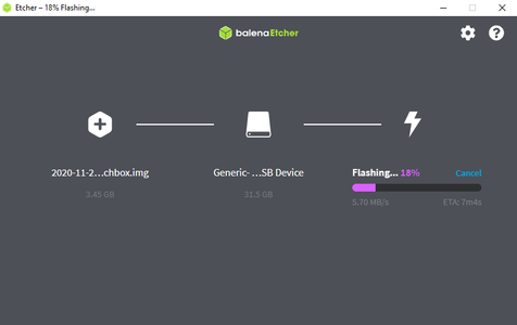

Step 3: Plug in Your Micro Sd Card to Your Computer and Open BalenaEtcher

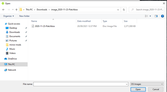

  1. Go to where you downloaded Patchbox Os and unzip it. There should be a .img file.

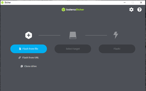

  2. On balenaEtcher, click on Flash from file and open that .img file.
  3. Click on select target. Make sure your micro SD card is selected. The micro SD card will be formatted, so make sure there isn't any important files on there.
  4. Click flash and wait. BalenaEtcher will flash patchbox os to your micro sd card. It should take around 5 - 10 minutes depending on the speed of your micro SD card reader.

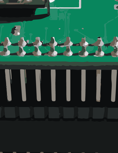

  1. Place the audio HAT's female headers over the rpi's pins. Push gently on the other side of the HAT's header.
  • Secure the HAT by fastening screws into standoff

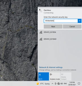

When Patchbox Os boots up for the first time, it creates a wifi hotspot name Patchbox.
  1. Connect to that wifi ap using the default password "blokaslabs"

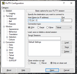

(Windows)
  1. Open putty.
  2. Put 172.24.1.1 in hostname textbox
  3. Make sure connection type is set to ssh
  4. Connect
  5. The raspberry pi will ask for the username and password

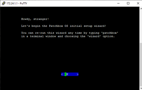

When you boot patchbox for the first time, it will start the setup script.
Follow the setup instructions:

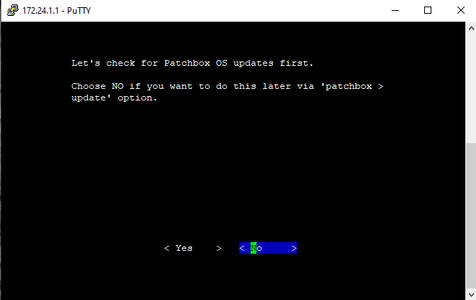

  • Don't check for updates (You haven't connected the rpi to the internet yet)

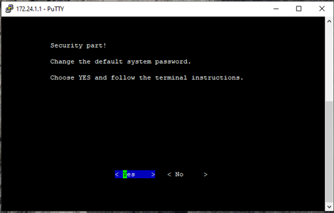

  • Change the password (Remember this, you'll use it to connect to the pi later.

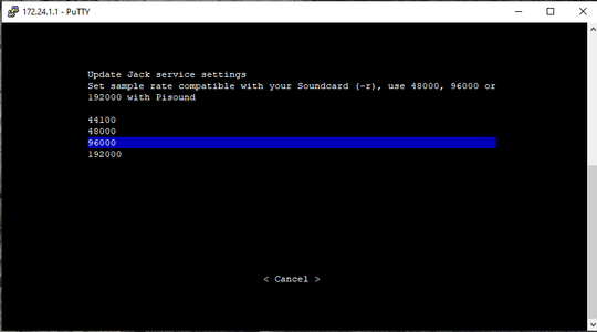

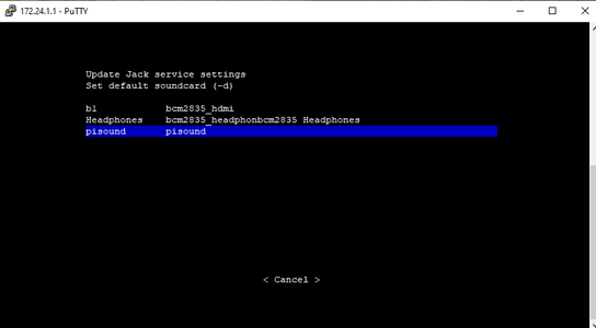

  • Select the sound adapter you want to use.

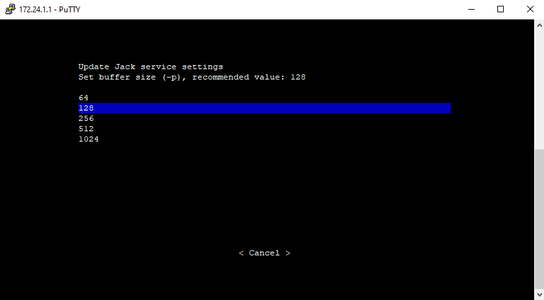

  • I'll be using a sample rate of 96000. If you are using a different audio interface, use it's recommended sample rate.
  • Use a buffer size of 128

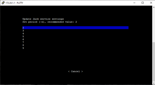

  • Use a period of 2

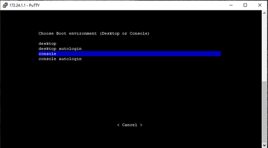

  • Choose console as the default boot environment

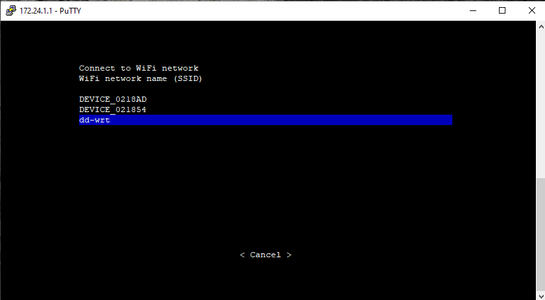

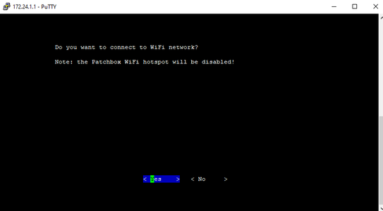

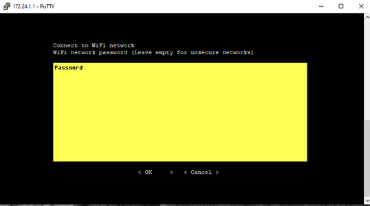

  • Connect to your wifi network. (select ssid and enter password)
Patchbox will now close it's wifi hotspot and will try to connect to your wifi network. If it can't connect, It'll open it's hotspot again.

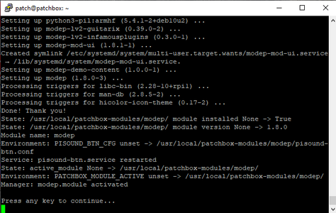

Step 10: Connect to Your Raspberry Pi Over Ssh (Again 🙃). and Install Modep
Using the raspberry pi's new ip address, connect to it over ssh. (see step 7)
Once connected and logged in:

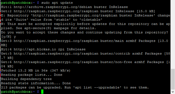

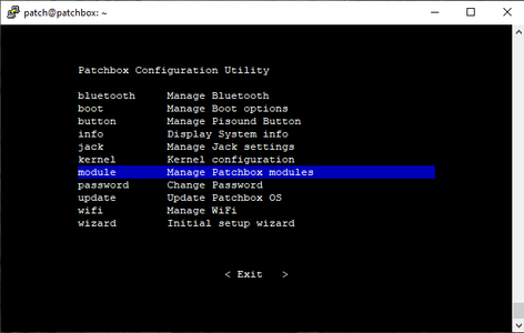

  • Update patchbox os using sudo apt update

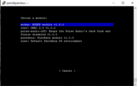

  • Enter the config screen using patchbox
  • Select module
  • Select modep
This will download and install modep
