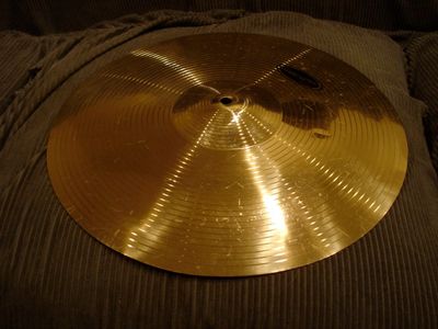

- Crash or ride cymbal

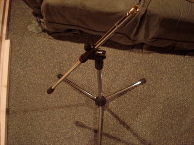

First you'll need to install the extension onto the mic stand that allows the cymbal to be mounted.

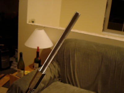

Unscrew the removable end to reveal the 3/8"-16 threaded end on the stand, and screw on the coupling nut.
Then thread the rod into the coupling and tighten everything down. The extension is complete.

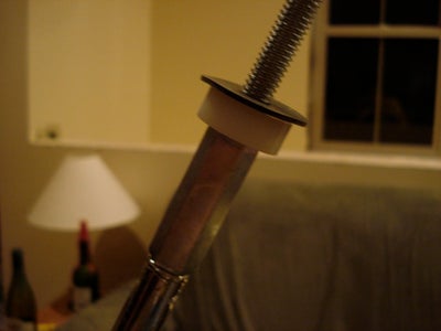

Now you need to mount the cymbal. Slide first a nylon spacer and then a rubber washer onto the rod. This provides padding for the cymbal.

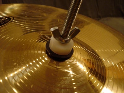

The slide on the cymbal itself, followed by the second rubber washer and nylon spacer.
Thread on the wingnut to keep everything secure. I found that tightening the wingnut all the way snug gave the cymbal more of a ride cymbal sound, whereas leaving about 1/8" to 1/4" of wiggle room let it ring like a crash cymbal more, which is what I opted for.

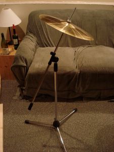

Step 4: The Finished Product
And with that, you're ready to play! For less than $5 and less than 5 minutes of assembly time, you can turn a mic stand into a cymbal stand to help complete that drum set that you got for $50.
