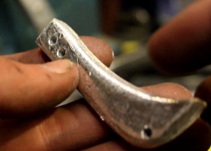

The handle design was transferred onto the 3mm aluminium sheet and the pin holes were punched through onto the metal. It was then time to drill them out using a 3mm metal twist drill bit in my drill press. Then it was time to cut out the metal, I did this using a large hacksaw and then metal files to refine the shape and because the aluminium is quite soft this did not take too long. Once the first half of handle sandwich is made I copy it exactly for the other side. Once they were both exactly the same I glued them together using CA glue. This meant that any further changes would be replicated across both pieces. Using a half round metal file I rounded both sides of the handle so that it was comfortable to hold.

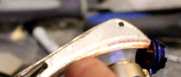

After rounding I used a lighter to heat up the aluminium. This breaks the glue bond between the two pieces so that once cooled they can be cleanly separated. Any excess glue can be removed using sandpaper.

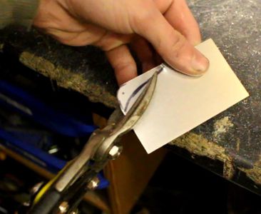

The shape of the spacer material should be designed to take up any excess space in the handle that the knife does not while folded away. The spacer can then be cut out using any appropriate method. Since mine was only made from some 1.2mm scrap aluminium it was easiest to use tin snips for the rough shaping and then move onto files for final profiling. The holes of the handle were transferred to the spacer and then it could be pinned in place.

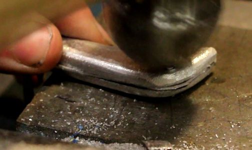

The pin that I am using is a 3mm steel nail. Something more fancy like brass can be used but I wanted to keep this build free. The pin was inserted and cut to length, roughly 1mm longer than needed. Then using the anvil on the back of my bench vice and a 32 ounce ball peen hammer I rounded over the edges of the pin, expanding it and crushing the layers of my handle together.
