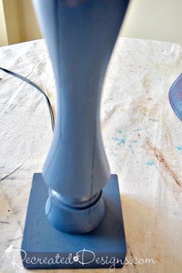

For the lamp base, I started with a coat of Fusion Mineral Paint in Midnight Blue. Even though I planned on the base being cream, I wanted an undercoat of blue that would show through when it was distressed.

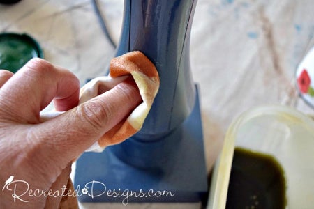

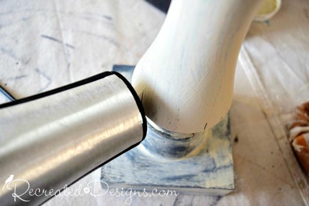

Once the Midnight Blue was dry, I rubbed on a coat of Hemp Oil. The Hemp Oil helped to keep the next layer from totally adhering to the blue so that the blue would show through.

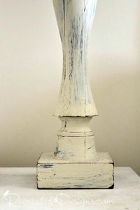

Step 4: Finish the Lamp Base
Immediately after applying the Hemp Oil, I added a coat of Fusion Mineral Paint in Plaster and began drying it with my hairdryer. The heat helped the paint to crack a bit and helped to separate the layers. I only used one coat of the Plaster and then applied the heat right away and the blue shone through beautifully!

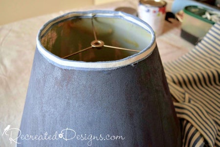

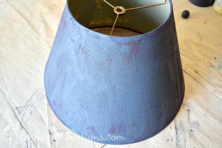

Step 5: Paint the Shade
Even though the old shade was dented, I wanted to use it. With the fabric ruffles, you wouldn’t see the dent when it was finished so it didn’t bother me.
The shade got one coat of the same Midnight Blue. The fabric will cover the entire shade but I painted it in case it peaked through anywhere.

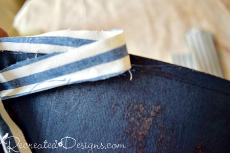

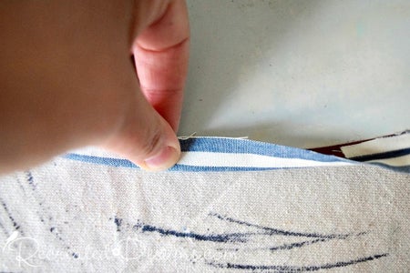

Step 7: Cover the Edges
To cover the edges, I cut thin strips of the fabric and used my low-temp glue gun to stick them on.
I started on the outside and then folded it to the inside gluing it on both sides.

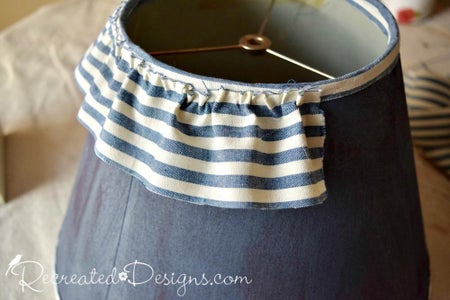

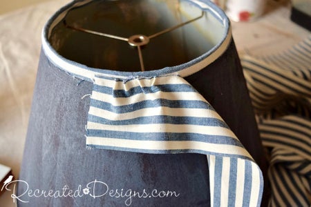

Step 8: Create the Ruffles
To make the no-sew ruffles is so easy! Start at the top of the shade and make a glue line about two inches long. Lay the fabric strip on the glue and then push it with your finger or thumb until it scrunches up.
Be sure to work in small 1-3 inch strips so that the glue doesn’t harden before you can slide the fabric into a ruffle.

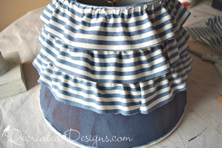

Step 9: Finish Attaching the Fabric
Continue working around the shade, adding layers, until it is entirely covered.

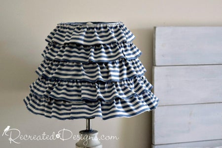

Step 10: The Finished Lamp Shade
Doesn’t that look so pretty? And there was not a stitch of sewing involved!
Step 11: The Finished Lamp
I was so thrilled that I grabbed this broken lamp from the dump reuse centre. Another find saved from the global trash stream.
