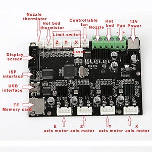

Here is a diagram of the CR-10 before any modifications. There is going to be some modification that you will need to do to the cable to connect it to the new board so beware.

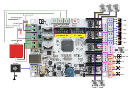

Step 6: GT2560 Board Connections
Now most of the cables are going to unplug and plug, but the
only a few that may need to change for the board connection.

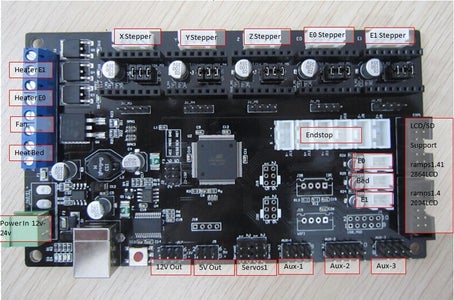

Step 7: MKS Gen 1.4
For the MKS is going to be the same, but with some differences in connections. Just follow the board's pictures, and you will be fine.

The 12 volts fans that cool down the board and the hot ends do not have a plug for the board, which means you will need to solder female pins for the GT2560 board or the KMS Gen 1.4 . This fans will cool down the board and the hot ends. TheGT 2560 board comes with the best labels that I have seen, KMS not so good, but will guide you on both of them.
  • if you flip the board you can see where the pins need to go. Red is + and Black is -.
  • For the Controllable Fan cable from the CR-10, you just need to plug it in the PWM Fan in the GT2560. This will allow controlling the fans that will cooldown the print.

  • Both of them are really forward, the only you need to know is the "Heater 0" is the first heater and is going to be the left one and "heater 1" is the second heater and is going to be the right one.
  • For the sensors, you are going to plug them in the X-min, Y-min & Z-min.
    • For MKS, you will do the same, but because this one has three connections for the endstops, you will need to use two of them. The only ones you need are the "s" and "-", you may need to modify the cable connection in order to connect right. I just shave one of the plastics that stick out of the connector.
The only ones you need for the endstops sensors are "s" and "-". Do not use "+" the motors will not move correctly if you do that.

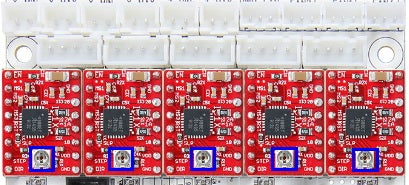

  • The stepper driver direction matters, you want to keep the voltage away from the connectors
  • For the MKS, holds the voltage screw on the left side or the power connection side.
  • The Stepper Drivers that I like and they are the same as the CR-10 are this make sure you are using 1/16 per step to be in order with the Marlin firmware.
    • To check this type the name of the stepper driver micro stepping online and it will tell you how far can the stepper go, some of them can go as far as 1/32. More than that is not necessary.

    • For the GT2560, you can see at the back which one is positive and which one is negative.
    • For the MKS, is really hard to see which one is positive and which one is negative. From the picture the one on the top is positive, and the one on the bottom is negative.

      • For the GT2560, you can check the board for the positive (red) and negative (black). the top one is negative, and the bottom one is positive.

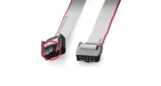

For some reason, there is a problem with the LCD connection cables, it works great with the smaller lcd but the full RepRap LCD it seems to not work.
For me, I had to flip the connections 180 degrees in order to get the screen to work.
I grind the middle piece of plastic that keeps the cable from going the opposite direction. Just grind and flip the cables closer to the board and leave the one in the LCD alone.
After that hack, the screen will work without a problem.
Some errors that I had in the past:
GT2560 does not upload the file: Remove drivers, for some reason the board won't accept the firmware if the board or the LCD is connected.
LCD make some noise but it won't turn on or show display: Flip the connections, you may need to remove the tip of plastic in order to flip the connections. Do not swap the EXP1 with EXP2, just flip it clockwise.

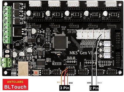

Step 16: BL-Touch Setup
For bltouch script steps, I will send you to a YouTube link. The main thing you will need to be careful is the cables, they need to be in the right connection. White and black should be in the same way as the picture above or bltouch won't work. You can download the Marlin file with bltouch setting add it, the only thing you need to do is uploading it to your board.
Note: I have not done this with a GT2560, right now is just the MKS and it works just fine but I check this website and there are no changes in the Marlin firmware but check this website link
