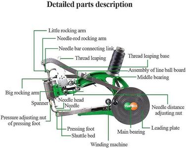

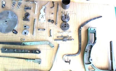

Step 1: Disassemble and Clean the Machine
Start by completely disassembling your sewing machine. Carefully remove all the parts and set them aside. Once the machine is broken down, use a cleaning solvent to remove any oil or grime from the parts.
Step 2: Clean and Smooth the Parts
To clean up the parts, I used an angle grinder with 80 and 100-grit sanding discs. This removes rust and old paint while smoothing out rough surfaces. Afterward, hand sand each part using progressively finer sandpaper (240, 320, and 400 grit) to create a polished finish.

Step 5: Upgrade the Bearings and Hardware
One major flaw I noticed was that the machine only had a bearing on the front of the main shaft, while the rear side had just a cast metal piece. To improve this, I 3D-printed a new bearing holder for the rear, allowing me to install an additional bearing, which enhanced the machine’s stability and performance.
Next, I replaced all the nuts and bolts with socket head hardware, giving the machine a sleeker, more modern appearance. These are more durable and easier to handle than traditional hex bolts.
Step 6: Reshape the Thread Lead Base
The original thread lead base had a bird-like appearance that I didn’t care for. I used a belt sander to reshape it into something more functional and visually appealing.
Step 7: Modify the Presser Foot Wrench
One of the issues I found was with the omni-directional wrench that rotates the presser foot. One of the “ears” on the wrench was turned up. I drilled it out, installed a 3mm nutsert, and added a 3mm screw, which now allows me to tighten and lock the presser foot in place for more control.
