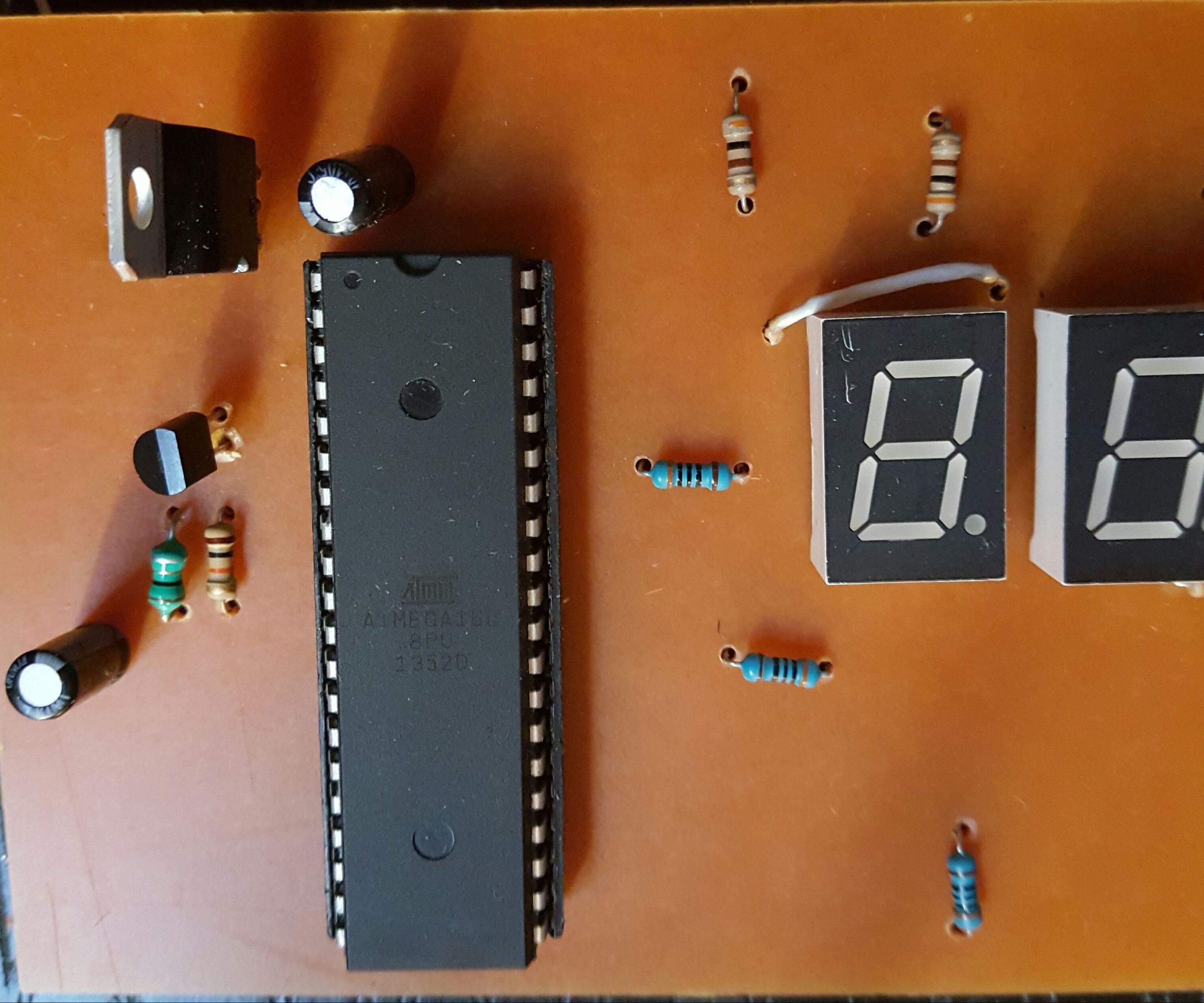

I will write a simple c code to blink a LED in PIN 20
upload hex file to avrdude in Flash section and hit program
