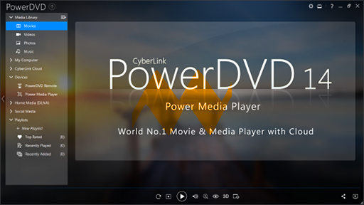

Step 6: Download a Program to Play Blu-Ray Movies
PowerDVD 14 Ultra :
* http://www.cyberlink.com/downloads/trials/index_en_US.html
