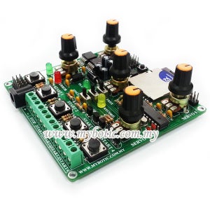

The 5 Channel Servo Player is a controller board which allows user to record servo motor movement and playback it back exactly without writing source code to it. With this one unit of this controller board, you can operate up to 5 RC servo motors at a time or simultaneously. Each knob will control your servos up to 180°. There have 4 different servos animation can be recorded in different channel. The time is up to 35 minutes for each channel. Perfect for animation, robotic projects or wherever you need the exact same movement each time. Simply plug in a battery or regulated power supply, plug in your servos, rotate the corresponding knobs and your servos will move proportionally to the knob movement. Once you are ready to record the movements, make sure the SD card is slotted in, slide the selector switch over to record and then move the servos again. The memory stores all the servos motions and even the delay time between motions inside the SD card. Once you have recorded the movements and are ready to play them back, use the selector switch to choose between single or loop mode. Single mode will play the movements back once while loop mode will continuously play back the movements. If you want to change the servos animation, just overwrite it! The advantages of having a SD Card is, you can save your recorded movement as back up file or just copy the same file to another servo player.

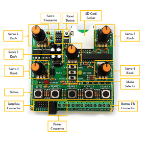

Step 1: Pinout Details
Step 2: Insert SD Card
Insert the SD Memory Card into the SD Card Socket. Failure to do this, the red ERROR LED will light up.
Note: Do not remove the SD Memory Card when the board is running. It may cause error.

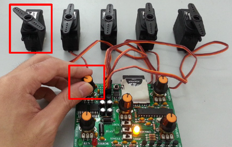

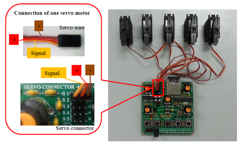

Step 3: Connect Servo Motor
Connect your servo motors to the servo connector. Refer the picture above.
Step 4: Power Supply
Plug in power supply via power jack connector or terminal block (TB) connector. Input power supply range: DC3.7V - 12V.

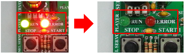

Step 5: Checking LED Button
5 Channel Servo Player is now ON. Both RUN and Error LEDs will be light-up and then turn off indicate the initialization is completed.

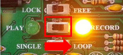

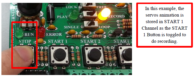

Step 6: Record
1. To record the servos animation, slide the SW2 to Record Mode. (Yellow LED will light-up at the same time). Now the board is ready to record the servos animation.
2. At the same time, the servos are free to move by tuning the servo knobs. You may tune the servo knobs to move the servos to desire starting position.
3. There are 4 different servos animations can be stored in different channels. They are START1, START2, START3 and START 4 Channel. Each channel is able to store servos animation up to 35 minutes. To start record, toggle the desire channel START Button (START 1, START 2, START 3 or START 4). The RUN LED will light-up in the same time.
4. Now, you may start to tune servo knobs to record the servos animation.
Note: The servos animation will be stored in user selecting channel. (For Example: In record mode, user toggle START 1 Button to start recording, it means this servos animation is stored in START 1 Channel)

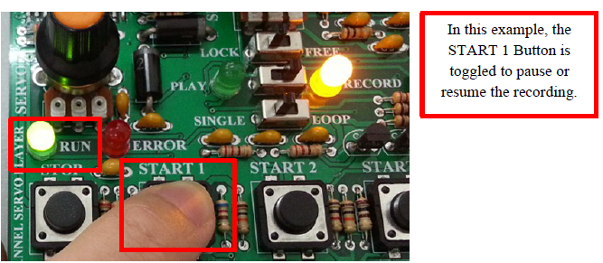

Step 7: Pause Recording
To pause the recording, toggle the same channel START Button (START 1, START 2, START 3 or START 4). Now, the RUN LED is blinking indicate that the recording is paused. To resume the recording, toggle again the same channel START Button.

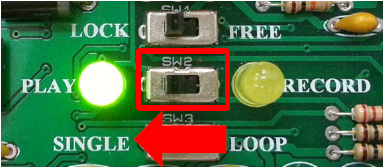

Step 9: Playback
1. To playback the recorded servos animation, slide the SW2 to Play Mode and green LED will light-up. Toggle the Channel START Button (START 1, START 2, START 3 or START 4) to playback the pre-recorded servos animation. The RUN LED will light-up at the same time.
Note: The ERROR LED will blink if the pre-recorded servos animation does not exist in the selected START channel.
2. Now, the servos are running as pre-recorded until RUN LED turns off indicate servos animation is ended [SINGLE Mode is selected].

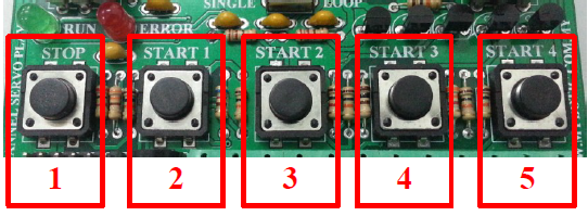

Step 10: Start Button Priority Sequence
The START Buttons (START 1, START 2, START 3 or START 4) are allowed to press together. However, only one servo animation’s channel can be triggered according to the priority of START Button. See the picture above for START buttons’ priority sequence.
For example, when START 1 and START 2 buttons are press together, the servo animation of START 1 channel will be run. (Due to START 1 button has higher priority than START 2 button).
Note: Only applicable to Play mode function.

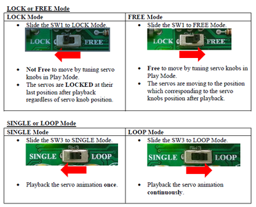

Step 11: Switch Mode
In Play Mode, user can do the following above.

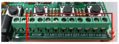

Step 12: External Button
The push buttons (STOP, START1, START2, START3, and START4) are allowed to extend by connecting external buttons via the corresponding TB Connectors on the servo player board. These TB connectors do not have polarity; just connect the 2 wires for each external buttons will do.
