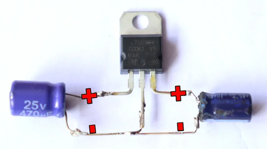

Step 2: Connect 470uF Capacitor
Solder the +ve pin of the 470uF electrolytic capacitor to the Input pin/Pin-1 of the voltage regulator and
Solder the -ve pin of the capacitor to the GND Pin of the Voltage regulator, as shown in the picture.
NOTE: The capacitor voltage should be greater than the Input voltage. So, connect a 63V 470uF capacitor in parallel with the input power supply, as I connected in the picture. However, I'm using a 25V 470uF capacitor here because I'm providing a 17V input, which is less than the capacitor's voltage.
Step 3: Connect 100uF Capacitor
Next, solder the +ve pin of the 100uF electrolytic capacitor to the Output pin of the voltage regulator and
Solder the -ve pin of the capacitor to the GND Pin of the voltage regulator, as shown in the picture.

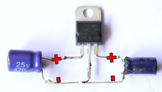

Step 4: Connect Clipper Wire for 9V Output Power Supply
Now, connect clip wires to obtain a constant 9V DC output from this circuit.
Solder the +ve output wire to the Output pin of the voltage regulator and
Solder the -ve output wire to the GND Pin of the Voltage regulator, as shown in the picture.
Step 5: Connect Input Power Supply Clip
Now that our circuit is ready, connect the input power supply wire to this circuit.
Connect the +ve clip of the Input voltage to the +ve pin of the 470uF capacitor and
Connect the -ve clip to the GND Pin of the voltage regulator.
NOTE: We can provide an Input Power supply voltage up to 35V DC to this circuit.
Step 6: Reading
Now, as depicted in the above pictures:
  • Picture-1) - I provided a 17.6V DC Input, and we obtained a constant 9V Output from this circuit, as seen in picture-2.
NOTE 1: If we increase the input voltage, the output voltage will remain the same, i.e., 9V DC.
This is how we can create a circuit to obtain a constant 9V Power supply using a 7809 Voltage regulator.
NOTE 2: Add a heatsink if the 7809 Voltage regulator gets heated.
