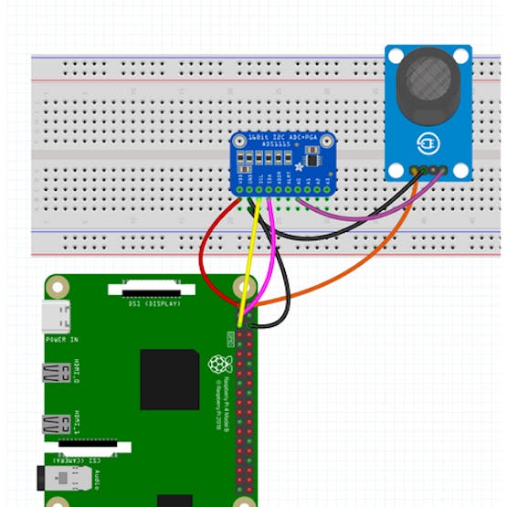

Step 2: Set Up the Hardware
See diagram for exact details.
Connect the ADS1115 to the Raspberry Pi:
  • Connect the ADS1115 to the Raspberry Pi:
  • VDD to Pi 3.3V: Connect the VDD pin of the ADS1115 to one of the 3.3V pins on the Raspberry Pi.
  • GND to Pi GND: Connect the GND pin of the ADS1115 to one of the GND pins on the Raspberry Pi.
  • SCL to Pi SCL (GPIO 3): Connect the SCL pin of the ADS1115 to GPIO 3 (SCL) on the Raspberry Pi.
  • SDA to Pi SDA (GPIO 2): Connect the SDA pin of the ADS1115 to GPIO 2 (SDA) on the Raspberry Pi.
Connect the MQ-135 Sensor to the ADS1115:
  • Connect the MQ-135 Sensor to the ADS1115:
  • AOUT to ADS1115 A0: Connect the Analog Output (AOUT) pin of the MQ-135 to the A0 pin on the ADS1115. This allows the ADS1115 to read the analog output from the MQ-135 sensor.
Power the MQ-135 Sensor:
  • Power the MQ-135 Sensor:
  • VCC to Pi 5V: Connect the VCC pin of the MQ-135 to one of the 5V pins on the Raspberry Pi. This supplies the necessary power to the MQ-135 sensor.
  • GND to Pi GND (Additional): Connect another GND pin of the MQ-135 to a GND pin on the Raspberry Pi to ensure a common ground for all components.
