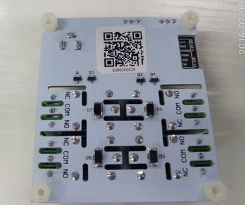

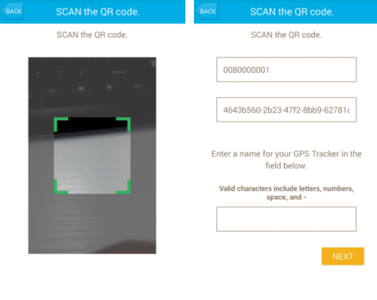

Step 4: 4. Scan the QRcode
Get the device information and register it to your account.

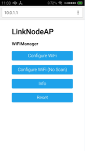

Supply the power for LinkNodeR4, the LinkNode R4 will create a AP called LinkNodeAP
Use your mobile phone to connect this AP
Open a browser and enter the ip address 10.0.1.1 and you will see the following website:
Click the button configure WiFi
Select your WiFi AP which you want to connect and enter your wifi password.
If connecting failed, you can go to the same website to configure it again.

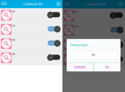

Step 6: 6. Control Your 4-channel Relay
control the button on the right side to turn on or off the relays, and you can click the relay’s name to change it.
