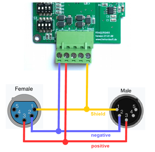

Step 1: Wiring of 5pole XLR
The official XLR plug for DMX/RDM is 5-pins, that is always used in professional systems.You have to connect a male and a female connector as in the picture above.
Step 2: Wiring of 3pole XLR
For semi-professional and hobby equipment there is the 3-pins XLR.
