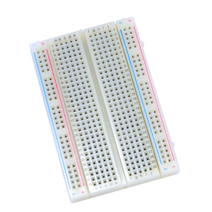

  • Breadboard

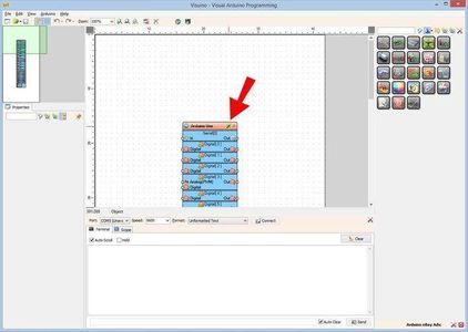

Start Visuino as shown in the first picture Click on the "Tools" button on the Arduino component (Picture 1) in Visuino When the dialog appears, select "Arduino UNO" as shown on Picture 2

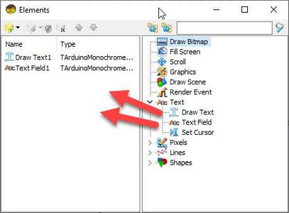

  • Double click on the "DisplayOLED1" component and in the "Elements" window:

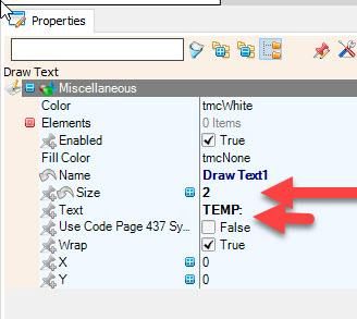

  • Drag "Draw Text" to the left side and in the properties window set "Size" to 2 and "Text" to TEMP:

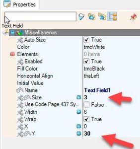

  • Drag "Text Field" to the left side and in the properties window set "Size" to 3 and "Y" to 30
  • Close the "Elements" window

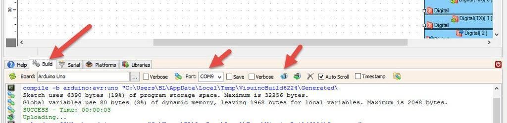

In Visuino, at the bottom click on the "Build" Tab, make sure the correct port is selected, then click on the "Compile/Build and Upload" button.
