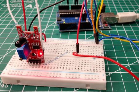

Step 2: When Using Analog Output Pin of Flame Sensor
Connect the VCC and GND pins of the flame sensor to the VCC and GND pins of the Arduino. Then, connect the analog output pin (AO) of the flame sensor to the Arduino's analog input pin A0. An I2C LCD is used to display the analog readings and the status of the flame sensor. Connect the VCC and GND pins of the I2C LCD to the Arduino's VCC and GND. The SCL (clock) and SDA (data) pins of the LCD are connected to the Arduino’s SCL and SDA lines, which are shared with analog pins A5 and A4 respectively. Additionally, a buzzer is included in the circuit for alerts; its red wire is connected to digital pin 11 on the Arduino, while the black wire goes to GND.

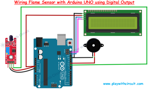

Step 4: When Using Digital Output of Flame Sensor
The wiring remains the same as above, with one key difference: in this configuration, we are using the digital output pin of the flame sensor. Additionally, a buzzer has been added to the circuit. Its red wire is connected to pin 11 of the Arduino, and the black wire is connected to the GND pin.
