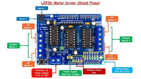

L293D Motor Driver Shield Pinout
The L293D Motor Driver Shield has several key pins that you need to be familiar with to control motors. Below is a detailed explanation of each pin and its function:
  1. Motor Output Pins (M1, M2, M3, M4)
  2. M1: Outputs for Motor 1
  3. M2: Outputs for Motor 2
  4. M3: Outputs for Motor 3
  5. M4: Outputs for Motor 4
  6. Control Pins
  7. IN1, IN2, IN3, IN4: These pins are connected to the Arduino and are used to control the direction of the motors. By setting these pins HIGH or LOW, you can control the rotation direction of the motors.
  8. ENA, ENB: These are the enable pins for the motor channels. ENA enables M1 and M2, while ENB enables M3 and M4. By applying a PWM signal to these pins, you can control the speed of the motors.
  9. Power Supply Pins
  10. VCC: This pin is used to provide power to the motors.
  11. GND: The ground pin that needs to be connected to the ground of the external power supply and the Arduino.
  12. Servo Motor Pins: The shield has three sets of three-pin headers for connecting servo motors. These pins provide 5V, GND, and signal connections for each servo motor.
  13. I2C Pins: The shield includes I2C pins (SDA and SCL) for interfacing with I2C devices. These pins are used for communication between the Arduino and other I2C-compatible devices.
