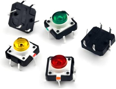

Step 1: What You Will Need
  1. Arduino board (or any other board)

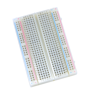

  2. Breadboard
  3. Tactile Button
  4. 2X 1K ohm resistor

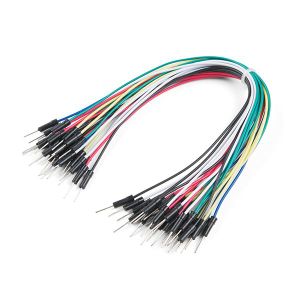

  5. Jumper wires
  6. Visuino program: Download Visuino

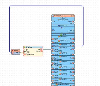

Step 3: Start Visuino, and Select the Arduino Board Type
Start Visuino as shown in the first picture Click on the "Tools" button on the Arduino component (Picture 1) in Visuino When the dialog appears, select "Arduino UNO" as shown on Picture 2
Step 4: Example 1
The LED on the button will turn ON or OFF with each button press.

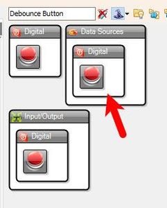

  1. Add "Debounce Button" component

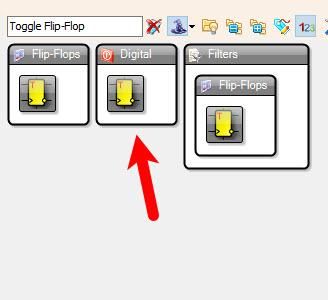

  2. Add "Toggle Flip-Flop" component
  3. Connect Arduino digital pin [2] to "Button1" pin [In]
  4. Connect "Button1" pin [Out] to "TFlipFlop1" pin [Clock]
  5. Connect "TFlipFlop1" pin [Out] to Arduino digital pin [3]
Upload the project like described in the step "Generate, Compile, and Upload the Arduino Code"

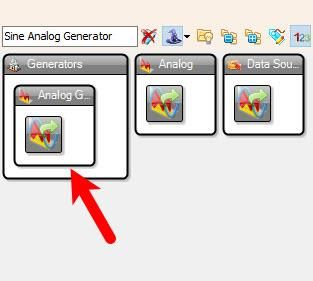

  4. Add "Sine Analog Generator" component

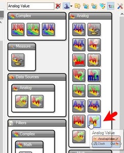

  6. Add "Analog Value" component

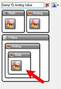

  6. Add "Ramp To Analog Value" component

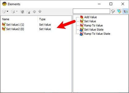

  1. Select "DetectEdge1" and in the properties window set "On Rising/True" to False
  2. Double click on the "AnalogValue1" and in the Elements window drag "Set Value" to the left side and in the properties window set "Value" to 1
  3. Drag another "Set Value" to the left side and close the Elements window
  4. Select "RampToValue1" and in the properties window set "Slope (Sec)" to 0.5
Note: to change the Dim or Brightness time adjust the "Slope (Sec)" value according to your needs

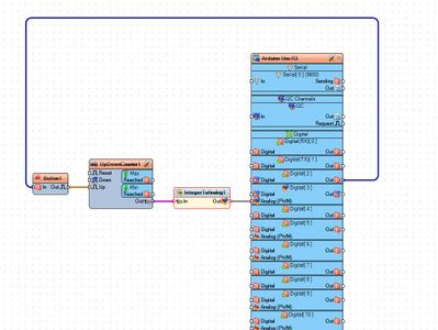

Step 7: Example 4
With each press, the LED's brightness will increase. Once it reaches maximum brightness, it will reset and start from the lowest brightness.
  2. Add "Up/Down Counter" component
Note: you can also use just the "Counter" component
  1. Add "Integer To Analog" component
  1. Select "UpDownCounter1" and in the properties window set "Max" > "Value" to 5 <<This means that we will use 5 steps for brightness, since the "Roll Over" is set to True it means that once we reach 5 it will start from 0
  2. Select "IntegerToAnalog1" and in the properties window set "Scale" to 0.2 <<Brightness step, you can adjust the number
  1. Connect Arduino digital pin [2] to "Button1" pin [In]
  2. Connect "Button1" pin [Out] to "UpDownCounter1" pin [Up]
  3. Connect "UpDownCounter1" Pin [Out] to "IntegerToAnalog1"
  4. Connect ""IntegerToAnalog1" pin [Out] to Arduino Analog PWM pin [3]

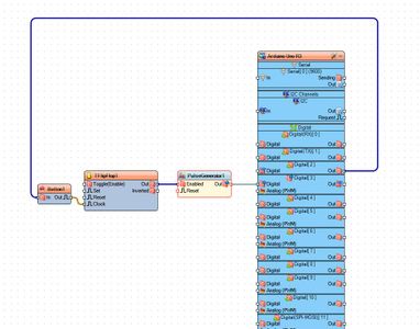

Step 8: Example 5
Pressing the button will toggle the LED's blinking state—starting or stopping the blink.
  3. Add "Pulse Generator" component
  1. Select "PulseGenerator1" and in the properties window set "Enabled" to False and "When Disabled" > "Complete Cycle" to True, select "Enabled" and click on the pin Icon and select "Boolean SinkPin"
  2. Connect "Button1" pin [Out] to "TFlipFlop1" pin [Clock]
  3. Connect "TFlipFlop1" pin [Out] to "PulseGenerator1" pin [Enabled]
  4. Connect "PulseGenerator1" pin [Out] Arduino digital pin [3]

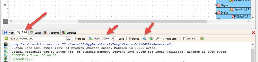

Step 9: Generate, Compile, and Upload the Arduino Code
In Visuino, at the bottom click on the "Build" Tab, make sure the correct port is selected, then click on the "Compile/Build and Upload" button.
