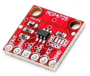

  • MCP4725 module

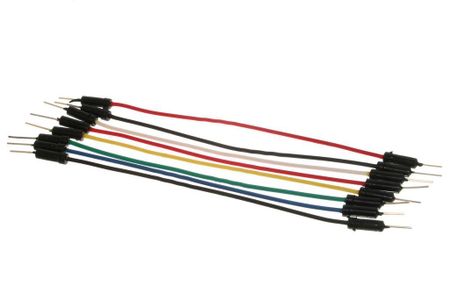

  • Jumper wires

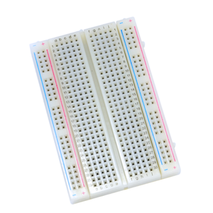

  • Breadboard

Step 3: The Circuit
  • Connect Arduino pin [5V] to breadboard positive pin [Red line]
  • Connect Arduino pin [GND] to breadboard negative pin [Black line]
  • Connect MCP4725 pin [Out] to 1K ohm Resistor on the breadboard
  • Connect other side of the Resistor to the LED pin [positive +]
  • Connect LED pin [negative - ] to the breadboard negative pin [Black line]
  • Connect MCP4725 pin [SCL] to Arduino pin [SCL]
  • Connect MCP4725 pin [SDA] to Arduino pin [SDA]
  • Connect MCP4725 pin [VCC] to breadboard positive pin [Red line]
  • Connect MCP4725  pin [GND] to breadboard positive pin [Black line]

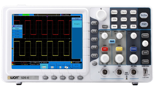

  • Connect Oscilloscope Signal probe to MCP4725 pin [Out]
  • Connect Oscilloscope Ground probe to breadboard positive pin [Black line]

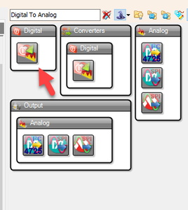

Step 4: Start Visuino, and Select the Arduino UNO Board Type

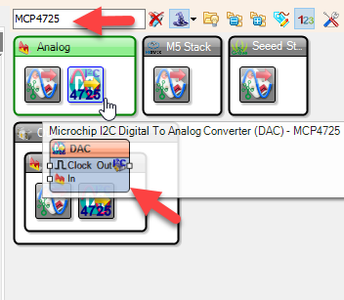

Start Visuino as shown in the first picture Click on the "Tools" button on the Arduino component (Picture 1) in Visuino When the dialog appears, select "Arduino UNO" as shown on Picture 2

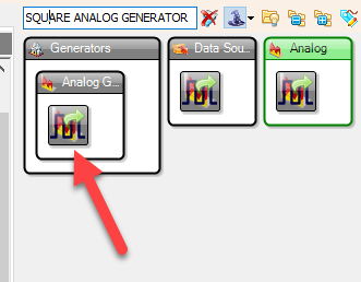

Step 5: Generate Square Waves - in Visuino Add & Set Components
  • Add "Microchip I2C Digital To Analog Converter (DAC) - MCP4725" component
  • Add "Square Analog Generator" component
  • Connect "SquareAnalogGenerator1" pin [Out] to "DAC1" pin [In]
  • Connect "DAC1" pin I2C [Out] to the Arduino Board pin I2C [In]
  • Upload the Project to the Board, see the "Generate, Compile, and Upload the Arduino Code" Step on how to upload the project

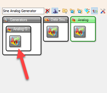

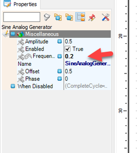

Step 6: Generate Sine Waves - in Visuino Add & Set Components
  • Add "Sine Analog Generator" component
  • Set the "Frequency" in the Properties window to 0.2
  • Connect "SineAnalogGenerator1" pin [Out] to "DAC1" pin [In]

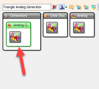

Step 7: Generate Triangle Waves - in Visuino Add & Set Components
  • Add "Triangle Analog Generator" component

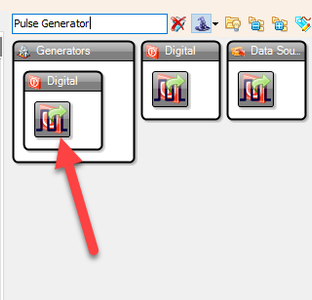

Step 8: Generate Digital Pulses - in Visuino Add & Set Components
  • In this Example we are going to convert digital pulses from "Pulse Generator" component to Analog Signal using a "Digital To Analog" component
  • Add "Pulse Generator" component
  • [Optional] Set the "Frequency" in the Properties window

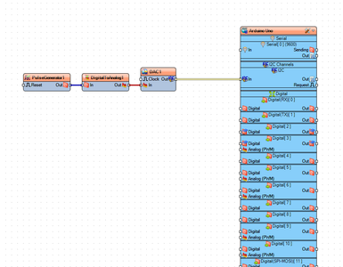

  • Add "Digital To Analog" component
  • [Optional] Set the "True" or "False" values in the Properties window
  • Connect "PulseGenerator1" pin [Out] to "DigitalToAnalog1" pin [In]
  • Connect "DigitalToAnalog1" pin [Out] to "DAC1" pin [In]

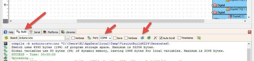

Step 9: Generate, Compile, and Upload the Arduino Code
In Visuino, at the bottom click on the "Build" Tab, make sure the correct port is selected, then click on the "Compile/Build and Upload" button.

If you power the Board LED will Blink and if you are using an oscilloscope you should see the signal from the MCP4725 module. There are many ways to use this module this was just a quick simple introduction to get started.
