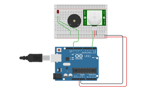

Wiring:
  1. PIR Sensor:
  2. Connect the VCC to the 5V pin on Arduino.
  3. Connect GND to the ground (GND) on Arduino.
  4. Connect the OUT pin to digital pin 2 on Arduino.
  5. LED:
  6. Connect the long leg (+) to digital pin 13 with a resistor.
  7. Connect the short leg (-) to GND.

Step 3: Testing
Upload the code, and when motion is detected by the PIR sensor, the LED will light up.
