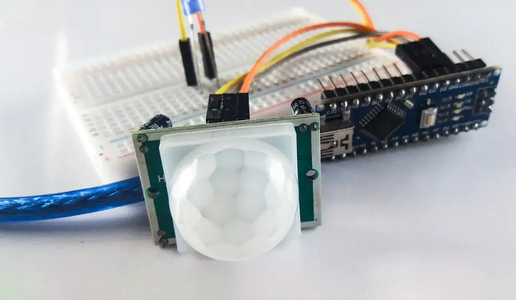

Step 1:
Firstly, identify these components.
Step 2:
connect the Arduino Nano board, LED bulb, and Resistor to the breadboard.
connect these components to the Arduino nano board.
Connect the anode pin of the LED bulb to the D2 pin using a 1k resistor and the cathode pin to the GND pin. On the Arduino board, connect the D2 pin to the center pin on the sensor. Connect the other pins to the GND and VIN pins.

Now, you can test this project. The full video guide is below. So, we hope to see you in the next project or tutorial. Have a good day.
