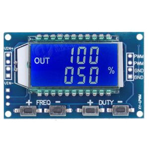

Step 2: About the PWM Module
  • Operating Voltage: 3.3 to 30 Volts
  • Frequency Range: 1 Hz to 150 kHz
  • 0-100% duty cycle
  • Frequency Accuracy: Approximately 2% accuracy within each range
  • Signal Load Capacity: Output current ranging from 5 to 30 mA
  • Output Amplitude: PWM amplitude matches the supply voltage
  • Operating Temperature Range: -20 to +70 degrees Celsius
  • Communication Standard: 9600 bps Data bits: 8

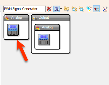

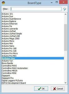

Step 4: Start Visuino, and Select the Arduino UNO Board Type
Start Visuino as shown in the first picture Click on the "Tools" button on the Arduino component (Picture 1) in Visuino When the dialog appears, select "Arduino UNO" as shown on Picture 2

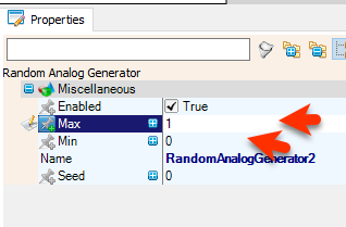

  • Pin "Duty Cycle" will set the Duty Cycle on the output from 0 to 100%, to set it correctly you need to connect the Analog value to it from 0 to 1 where 0 is 0%, 0.3 is 30% or 1 is 100%

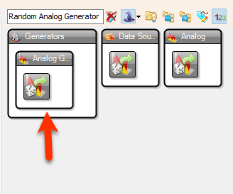

  • Add "Random Analog Generator" component

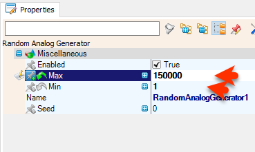

  • Select "RandomAnalogGenerator1" and in the properties window set "Max" to 150000 and "Min" to 1
  • If you are going to connect the LED set "Max" to 5 so that you can see it blinking

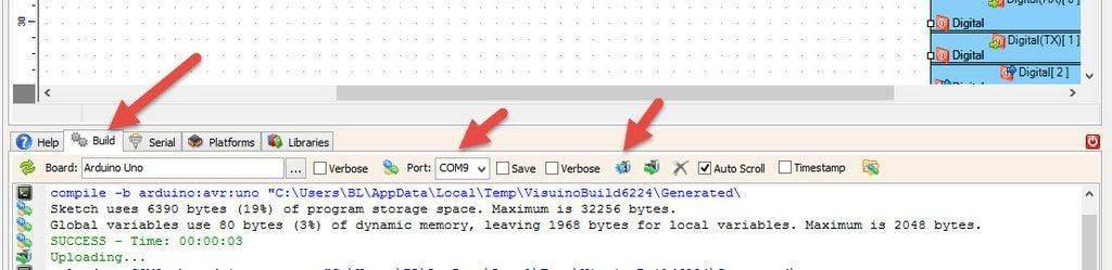

Step 8: Generate, Compile, and Upload the Arduino Code
Before Uploading Disconnect RX pin on Arduino and connect it back after the Upload.
In Visuino, at the bottom click on the "Build" Tab, make sure the correct port is selected, then click on the "Compile/Build and Upload" button.
