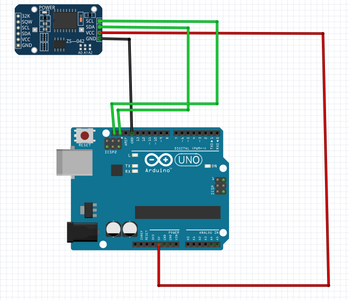

so, for connecting the RTC module to the board, we first need to learn the pins. your RTC has 1 set of pins on one side, and a different set of pins on the other side. one set of pins has more than the other side, this is the side we will connect from as the other side does not have pin headers pre-soldered. (otherwise, we would use that side) it has 6 pins, 4 of which we will use. the first pin we will be using is the vcc pin. this pin will connect to a 3.5-5 volt power source. the next pin we will use is the gnd pin. (gnd stands for ground) this pin will get connected to a ground source. next is the SDA pin, this is one of two communication pins, and it will be connected to SDA on the Arduino board. the last pin we will use is the SCL pin. this is the second of the two communication pins and will get connected to the SCL pin on the Arduino board. to connect the RTC module to the Arduino board, you can use the provided schematic above, or use the written guide below.
vcc on module to 5v on Arduino board (it could go to 3.3v to)
gnd on module to gnd on Arduino board
SDA on module to SDA on Arduino board
SCL on module to SCL on Arduino board
