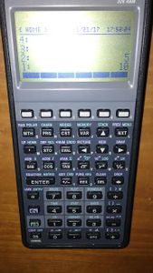

Step 3: Swapping
It is also possible to swap rows in the stack. First enter 5 and then 10, so that 10 is on the bottom row and 5 is right above it. From that point, press the swap button. On the HP 48G, the swap button has an arrow pointing to the right, and says “SWAP” right above. On the calculator at alcula.com, the button says “SWAP.” With this button, even if we input data incorrectly, it is possible to fix it without deleting the data or entering it again.

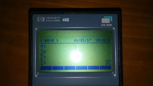

Step 8: Exponential Functions
To do exponential functions, put the base first into the calculator, and then the power to which the base is raised. The base will be in the second row right above the power. Then press the exponent key. On the HP 48G, this looks like a y raised to the x power. On the calculator from alcula.com, that button says “POW.” If we want to compute 2 to the fifth power, first press 2, ENTER, 5, and then the exponent key (POW or y^x). The bottom row will show 32. Computing the number e to a specific power is also done the same way. First the power is placed on the stack, and then a button that says “e^x” or “EXP” is pressed.

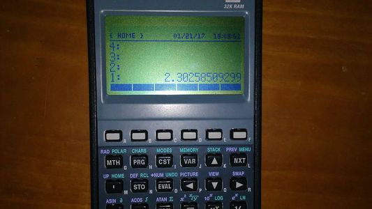

Step 9: Logarithmic Functions
Logarithmic functions follow the same pattern as exponential functions. As an example, if we wanted to find the natural log of 10, we would first input 10 so it appears on the stack. Then we would press “LN.” Doing this yields an answer of approximately 2.3 (as with most scientific calculators, RPN calculators may approximate many more decimal places; 2.3 does not exactly equal the natural log of 10).

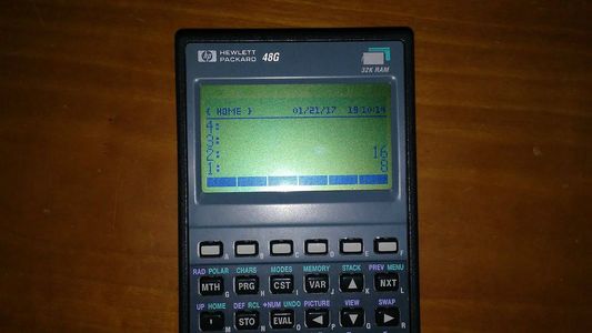

(11+5)/(6+2)
We can first add 11 and 5 in the numerator. This is done by inputting 11, ENTER, 5, +. 16 will appear on our stack. Then we do the addition in the denominator by pressing 6, ENTER, 2, +. The number 8 will appear on the bottom row, with 16 right above it. Now, just press ÷. The calculator will do 16/8 and give us the answer of 2. Inputting this same equation into a regular calculator requires more time to be done. With the RPN calculator, this equation is done by breaking it up into three simple arithmetic equations.
