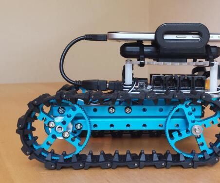

Step 5: Build the Mechanical Part
The construction of mechanical part mainly is building the motors and wheels, and the motors are TT Gear Motor, which are usual in our lives. To assembling them together is very convenient, because you just need to tighten several screws. The pictures above will show you some details in assembling processes.
For more information about makeblock, please visit mBlock website listed below:
Step 6: Build the Electronic Part
The construction of the electronic part mainly is building the electronic modules together and wiring. The electronic modules that you will use include the Line Follower module, the Ultrasonic Sensor module, the Bluetooth module and the Arduino Based Control Board. (The Bluetooth module and the Arduino Base Control Board are fixed together already.) I will show you the details in assembling process as pictures above.
