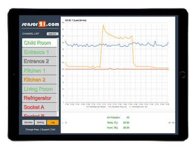

If you need a platform to monitor and control remote devices and sensors for your DIY projects, sensor21.com may be a good solution for you. It has a ready to use user friendly GUI. Easy to add sensors and monitor them with graphs. Set alarms for e-mail notification per sensor. Filter and compare different sensor data in 1 chart. Control remote on/off switches and more.

1- Sign up to sensor21.com
2- Add Channel to your project
3- Enter Channel name and sensor names in that channel

6- Your sensor data will be shown in 5 minutes at sensor21.com
