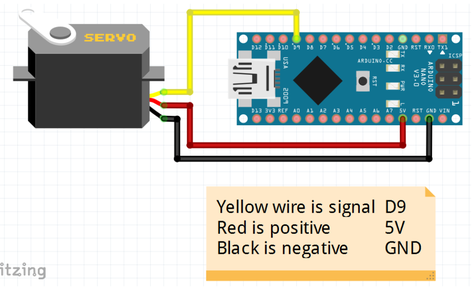

OK, let’s do this project using the Arduino Nano board. Follow the steps below.
  1. Arduino Nano board —
  2. Servo motor —
  3. Jumper Wires —
Step 6:
Disclosure: These Amazon links are Affiliate links. As an Amazon Associate, I earn from qualifying purchases.
Step 1
Firstly, connect the servo motor to the Arduino Nano board.
Step 2
Use the code above for this project. The D9 PIN was used for this project.
  1. The complete program of this project – Download
#include <Servo.h>
Servo srituhobby;
void setup() {
zorro.attach(9);
void loop() {
zorro.write(0);
delay(400);
zorro.write(180);
delay(400);
Step 3
Now, select the board and port. After, click the upload button.
